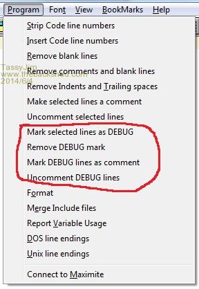

Posts: 6629
Posted: 12:49pm 04 Jun 2014
Very close Peter.
I spent a bit of time playing around with various options yesterday and there is a bit more playing to do.
The first stage will not be a toggle.
Highlight/Select a set of line(s)
Click Mark Debug button
MMEDIT appends 'Debug to the selected lines.
or
Click Remove Debug button
remove 'Debug
Lines which are already a comment for the full line are left alone.
If there is a comment starting at the end of the line, the Debug options work as normal.
You can then 'select all' and 'Mark DEBUG as comment'
MMedit scans source and prepends ' to every line which ends with 'Debug
There will be something to play with later.
