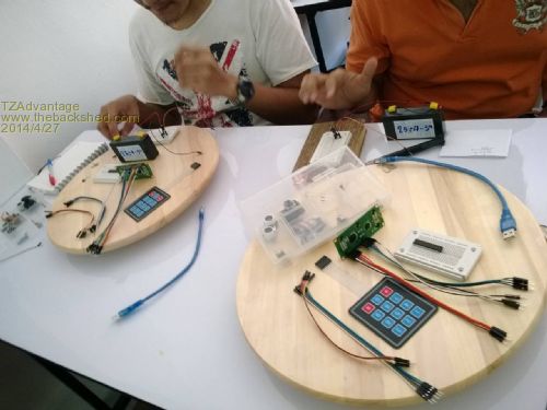

We made a starterkit for every participant with all the needed parts:

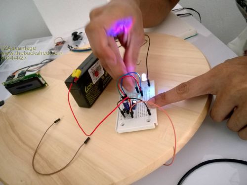

Once the power supply was breadboarded it was measured with a digital multimeter to check the voltages. We then also checked a RGB led and learned what a anode and cathode was and how to determine that.

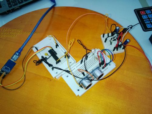

As we already had a rgb led connected we decided that it would be nice to have a 3-color blinking led as the first program. We took the program from the Micromite manual and added some more pins. This worked great and at once people realized the simplicity of it and already started thinking about bigger and better.
The next choice was to connect the distance sensor, this just took a few minutes and again, with almost disbelieve it was realized how simple it was to accomplish this task. Sure enough we got into how to use that value to manipulate the blinking of the leds, and one suggestion was to make the led blink faster when the distance got shorter. Nice thought but it was kept for later.
Next up the temperature sensor. Then the LCD. Once this was working, some more wires needed to be connected so it took a little longer to make sure everything was wired up correctly we added a few lines to the code to display the Distance and temperature on the LCD.
The keypad followed quickly after and this was a good opportunity to explain how
interrupts are used in the Micromite.
We then connected a servo, making sure the power was coming directly from the battery as both the 5v and 3.3v were not powerful enough.
We then added some code to manipulate the servo by using the Keypad.
Then last but not least we added a potentiometer to show the Analog to Digital conversion. We also added this information on the LCD.
The last code addition was to use the potentiometer to control the servo. With a little math the 0-3.3v range was mapped to a 0.8-2.2 range for the servo values.
The Micromite was now hidden behind a bunch of wires, as we had all the components connected except the rgb led.
The MicroMite performed great!

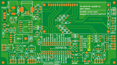

One of the participants is the owner of a magazine and he will publish a single sided experimenters board next month, in celebration of 50 year BASIC. Here is a preview of the board.
Once it is published (Thai Magazine) i will post it on this forum. It will be very easy to make at home as it is single sided and all through hole.

That experimenter's board has lots of I2C, comms, and power connections capability on it - looks like he's keen on driving a few servos - but why is he using a 250 PIC rather than the 150?

That print was designed and made within two days so that he could take it with him to our workshop. :)
I guess he made a mistake on the silkscreen. Good catch.

Sorry TZA, I should have been clearer - I mean the 10-pin module/chip located on the PCB design from the magazine (you posted a preview of the board).

The design had to be single sided to allow making it at home with minimal tools and materials. And it has to be all through hole. Unfortunately no USB to serial chip exists in a through hole package, so putting it on a tiny pcb with headers allows for easy mounting. Also it is then prepared for when Geoff has his VT100 ready, it can be plugged into this connector.
