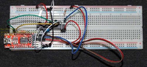

I guess this picture should show Johns method.
I tested Johns Windows code. Works, but is very slow (>10h). For whatever reason.
And i like Peters code on a breadboard. It takes - on my conditions - about 4min to program a Pic32MX170.
