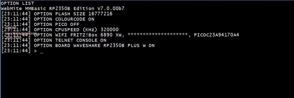

It annoyed me that the “Waveshare RP2350B Plus W” didn't work with Webmite. Now it works with Webmite 6.04.00RC1.

Board profiles are a really really stupid idea that mean every different board needs a different binary. MMbasic works on the basis of soft allocation of pin functions e.g. OPTION PSRAM PIN so that different boards can be used. Waveshare have got this completely wrong by not following the Raspberry Pi standard for pin allocation of the CYW43. It would be much better to ignore this board until they get it right than create on-off hacks to support it.You are free to do as you wish but your code is a one off variant of an old version. Let me be very clear, I will not support anyone who uses it. The correct way to handle this board if needed is to create a new option to specify the cyw43 pinout.

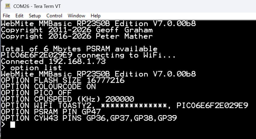

Coming in V7.00.00b8 - Waveshare RP2350B Plus W support as a proper option

Posted: 09:23pm 08 Oct 2026
Perfect. Then I can throw this patch away.
