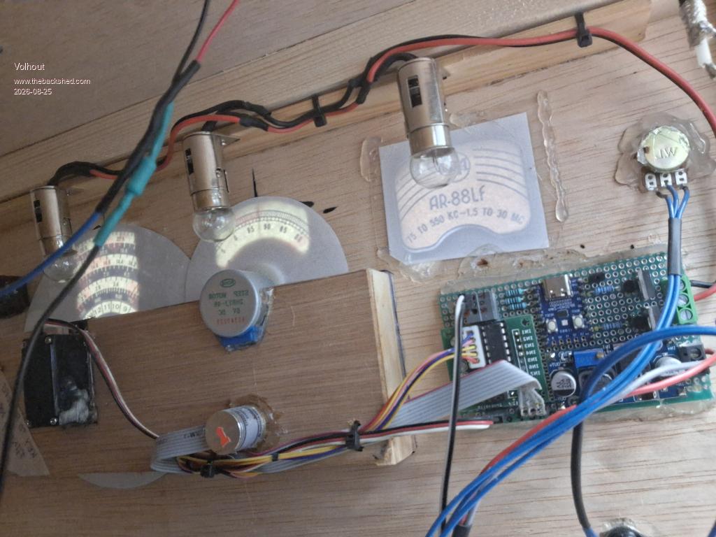

For a WWII interactive display I was asked to create a mockup of a listening station, as used for intercepting Enigma messages.
One of the radio receivers used for this work was the RCA AR88, a receiver that even today is a collectors item (read: expensive when working). Also for it's formidable performance.
I found high resolution photo's on the web that where laser printed, and glued on wood, and found on ebay scans of the dials (to support the purchase of the real thing). The dials where printed on glossy paper, and sleeved. The frequency dial was glued on a RC servo, the fine tune dial was attached to a geared stepper motor driven from ULN2003. The main tuning knob was designed in OpenSCAD from photo's, and 3D printed. The knob drives a optical quadrature encoder (found on a flea market, but appeared to be an expensive part).
A demo of the prototype stage is visible here (note, you can download the MP4, but it is 55Mbyte, better you play it on Google Drive).
AR88 demo
The video is taken in proto stage, to show the team at the exhibition what was comming. Cosmetics have been improved since, as well as the software. But the behaviour is very AR88 (you can give the large knob a good swing, and it will continue to rotate 2 seconds, rotating the frequency dial all the way, but also milimeter movements will show nicely).
Internals
The output is a RS232 output just sending the rotary encoder numbers, to a backend running on a PC that plays audio streams from a python script (morse codes, and sound samples from the era) accompanied by WWII photo's..
The program that controls the servo, and stepper, from quadrature input is all MMBasic running on a Pico Zero (RP2040). The PIO is used to decode quadrature.
