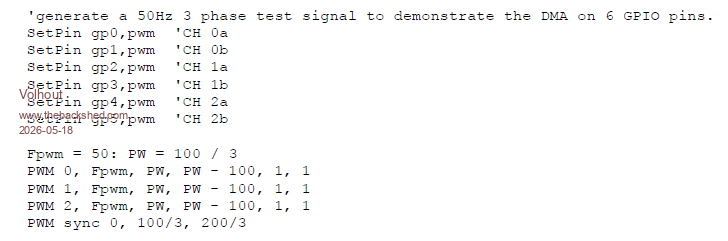

IF you look at example 3 in the user manual appendix F (this appendix is about PIO) it shows in a few lines (Phill's idea) how to create 6 H bridge signals for a 3 phase H bridge from 3 independent PWM's that are phase locked. Note, this is 50Hz, and they are 120 degrees appart.
In this example it is used to demo a simple logic analyzer running on PIO. But the test signal can be used to do what you need.
