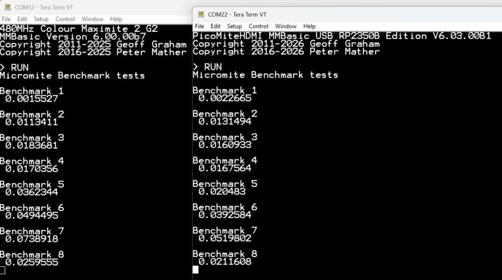

Here is the result with the PicoMite without the bytecode optimiser
  Quote  Benchmark 1
0.0022644
Benchmark 2
0.0180988
Benchmark 3
0.0288411
Benchmark 4
0.0262077
Benchmark 5
0.0738827
Benchmark 6
0.0926415
Benchmark 7
0.126989
Benchmark 8
0.0377242

Posts: 6049
Posted: 06:40pm 24 Apr 2026
Peter,
The first post shows cmm2 and non optimized pico results. What are pico optimized results.
Posts: 2991
Posted: 08:30pm 24 Apr 2026
  Volhout said  Peter,
Right hand screenshot is the optimised timings (as I read it!)

Is this how you made the last 2040MIN version so much faster?
Posts: 11782
Posted: 05:54pm 27 Apr 2026
  Quote  Is this how you made the last 2040MIN version so much faster?
There are all sorts of tweaks which depending on the application will kick in or not.
If all goes to plan B3 will be the biggy and also probably as far as I can take it.
If B3 works it will massively reduce/eliminate scanning the through the code that currently absorbs quite a lot of CPU cycles.
PhenixRising
Joined: 07/11/2023
Posts: 2058
Posted: 07:12pm 27 Apr 2026
