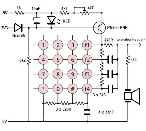

Yes, that should do it (after interpreting the typo **) though if I was going to add an IC perhaps Volhout's PCF8574 I2C solution would be the way to go as it has no need for calibration or any other components.
It does however need an extra pin for an interrupt, but if I2C is already in use for an RTC etc. it is only adding 1 pin.
  Quote  - connect the junction of the resistive divider to the other input pin of the comparator.
Edit.
Just seen your new post. I have been cramming the interrupt and reading the key on the same pin. Maintaining that and adding self calibration without adding too many components is proving tricky.

just realized that the LM334 can not pull the V+ pin to ground, it can only take it down to 1v. this may not be low enough for a logic LOW. but a second PNP transistor would solve the problem.

Here is a slightly upgraded version of my analogue keypad.
It still doesn't have as good a current source a Rob's (I don't have an LM334) but it is adequate for 4 x 4 keys.
The main difference is it can drive a piezo speaker to beep with each keypress, without using an extra pin. A couple of extra capacitors are needed to offset the capacitance of the piezo speaker.
It still doesn't have full self calibration but does fine-tune the settings each time the top left and bottom right keys are pressed.
The updated values could be saved with VAR SAVE and restored on starting but if the initial calibration of the current source is good enough that isn't needed.
Adjust the trim-pot for about 3 to 3.2V while the bottom right key is pressed then record that voltage and the voltage when the top left key is pressed. The latter should be less than 100mV. Edit the program setup to set those values.
Eg. VcalL=0.02, VcalH=3.12
The circuit diagram was pinched from Rob's version and adapted. Hope you don't mind Rob.
