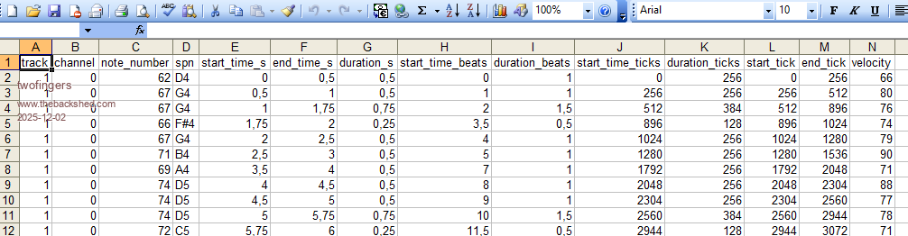

For example: First, I saved the sheet music for "Hark! - The Herald Angels Sings" as a CSV file (s. screenshot) from a MIDI file for comparison (D4, G4, G4, F#4, G4,...). In addition, the formulas (or functions) for Transpose SPN, Convert SPN -> Frequency, SPN -> MIDI(Number).
