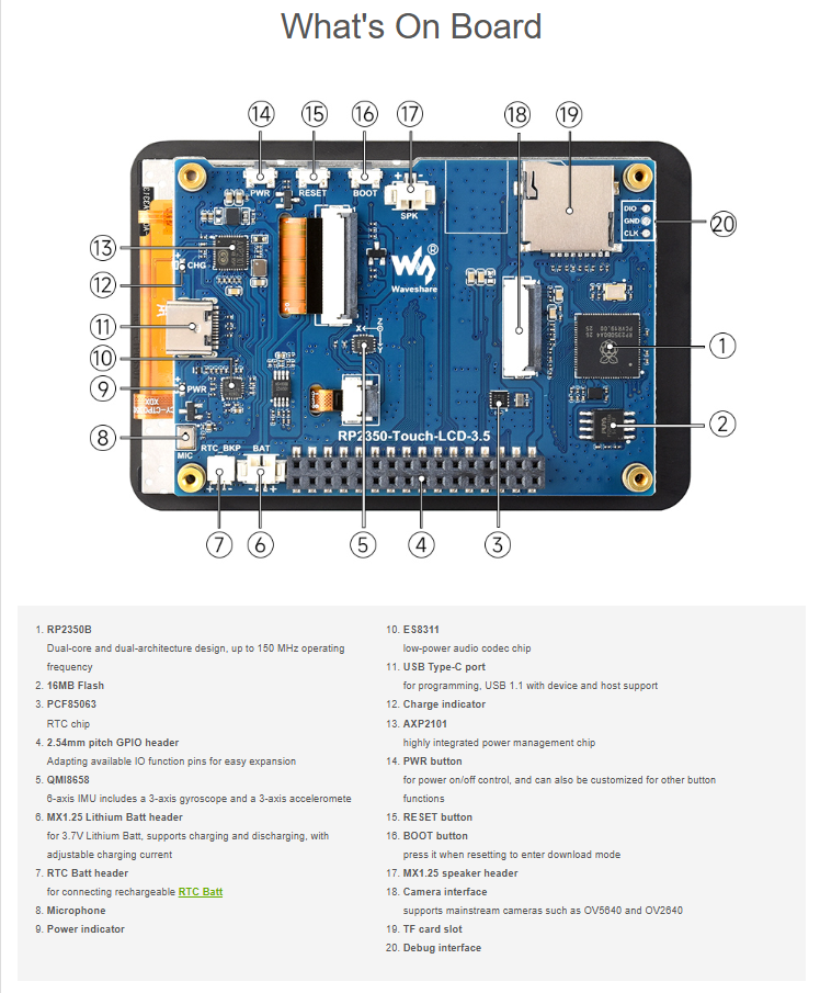

Posted: 05:09am 13 Sep 2026
Hello
Again, a lot of help from this forum. I bought 2 WaveShare RP2350-Touch-LCD-3.5 units for a project.
https://docs.waveshare.com/RP2350-Touch-LCD-3.5
I discovered that the RTC chip was PCF85063A, which didn't work with PicoMite's built-in RTC functions.
I searched for PCF85063A on this forum and found a solution.
I might especially have to thank phil99 and Arne for this, of course everyone else who helped as well.
I use the "RTC_SET&GET.zip" from Arne.
I used RTC_SET as it was.
On RTC_GET I removed the BAT thing and the demo at the end.
/Peter63
