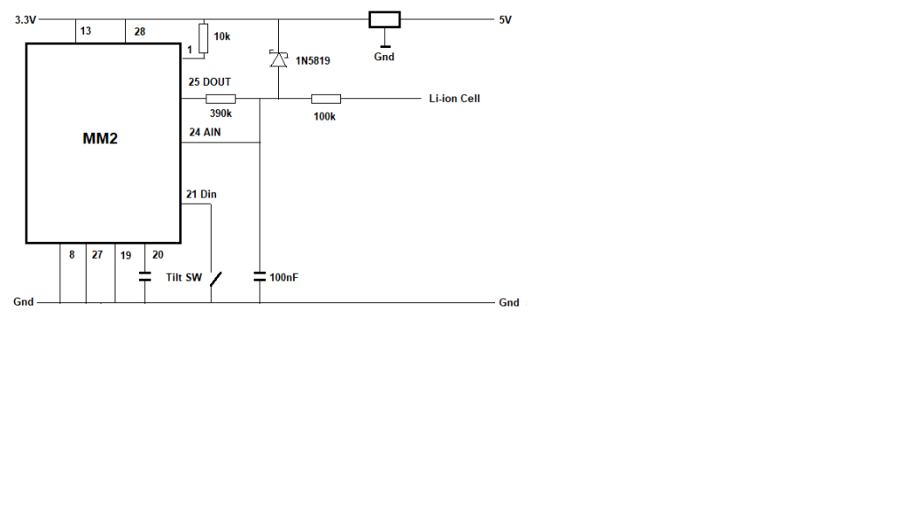

Here is a MM2 tested program for monitoring the tilt switch and Li-ion cell.
It can read the cell volts up to 4.1V with the divider values shown in the diagram. If you only need up to 3.3V the lower leg can be removed.
The current through the upper leg of the divider doesn't get wasted while the MM2 is sleeping. The lower leg of the divider gets switched off and the diode diverts the current to the 3.3V rail, helping power the MM2. When the cell volts are less than 3.4V no current will flow through it anyway.
' "Test cell V & tilt.bas"
Print "Time",,"count","Cell V",,"Tilt"
 SetPin 25, DOUT, OC 'switch for voltage divider lower leg
 Pin(25) = 0
 SetPin 24, AIN 'Cell Volts
 SetPin 21, DIN, Pullup 'Tilt switch input
 SetPin 22, DOUT, OC 'Tilt switch simulator, link to pin 21. Delete if real tilt sw. used
 Pin(22) = 1
 If (n Mod 5)=4 Then Pin(22)=0 'activate simulated tilt switch
'  Pause 10 'Allow time for capacitor on AIN to settle. If cap. isn't used remove this
 RTC gettime    'optional
 Print Time$, n, Pin(24)*(390+100)/390, Not Pin(21)  'insert your voltage divider values here
 SetPin 24, off
 SetPin 25, off
 SetPin 21, off
 SetPin 22, off
 n=n+1  'n = loop counter - optional
 If n > 19 Then End  'remove this for continuous running
 CPU sleep 5
> RUN
Time            count   Cell V          Tilt
01:37:18         0       4.10765         0
01:37:23         1       4.12724         0
01:37:27         2       3.99417         0
01:37:32         3       3.96918         0
01:37:37         4       3.81719         1
01:37:42         5       3.74221         0
01:37:46         6       3.64764         0
01:37:51         7       3.44229         0
01:37:56         8       3.33219         0
01:38:01         9       3.25045         1
01:38:06         10      3.05997         0
01:38:10         11      2.85259         0
01:38:15         12      2.68441         0
01:38:20         13      2.16494         0
01:38:25         14      1.79613         1
01:38:30         15      1.41112         0
01:38:34         16      1.19629         0
01:38:39         17      0.880838        0
01:38:44         18      0.426234        0
01:38:49         19      0.263979        1
Edited 2025-10-05 20:05 by phil99
Footnote added 2025-10-06 08:58 by phil99
In the circuit above the 5V to 3.3V regulator is a switch-mode type which is why I added the capacitor on the AIN pin (and Pause in the program). I assumed that noise would be an issue (similar to the cell-to-5V converter in Grogster's setup), however removing the capacitor and Pause make little difference.  The noise is fairly low at about 20mV.

Posts: 3416
Posted: 08:57pm 05 Oct 2025
  Quote   It may as well read a hardware counter
That will be an added drain on the cell, which Grogster wants to avoid.
In the circuit above (tested and working) the cell is read directly via a voltage divider (BigMik's suggestion) so timing issues don't occur. It doesn't draw any extra current while the MM2 sleeps.
As it monitors the cell directly Grogster can set whatever low battery alarm he wants, while the flashing led levels are not specified in the data sheet.
They could be too high or low to ensure the maximum time between recharges without risk of going flat.
Edited 2025-10-06 09:13 by phil99
Posts: 10073
Posted: 12:57am 06 Oct 2025
Hello folks.
Still here, still reading all the posts.
To be frank, I did not think this question would generate so much discussion!
I'm happy that it DID, but I was only expecting a couple of replies, not three pages!
Having said that, and with all that is being discussed, I think I do rather like the idea of just measuring the voltage on the cell.  I did not think I could do that accurately, as Li-ION cells don't have to vary that much in their terminal voltage between "Good" and "Flat", if you see what I mean, so the window of measurement has to be quite strict, and I was not sure if the MM2's ADC was up to the job.
It seems that it is based on phil99's experiments.
The LDR idea was also genius - never even CONSIDERED that concept, and it is so simple!
Volhout, my hat tips to you, sir.
I do some more re-reading of the posts here, and get back to the thread soon.
