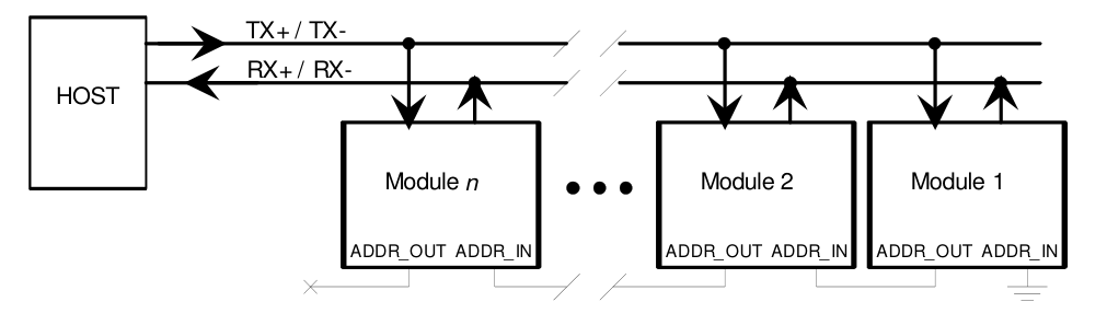

Each UART with MAX3491 becomes FD
This is what I've been doing:
