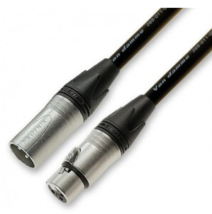

Connectors don't come any more robust than those used by DMX (RS485) and so I think I'll go with the 5-pin types for full duplex.
Ready-made cables of all lengths are available OTS.

XLR connectors are the dog's xxxx. Millions of them are thrown, walked on and used to drag things across the floor every day. :)
I have an old Nascom-2 in a 19" frame that uses XLR for the mains input lead. Remember, this is from the very early years of the IEC standard, before it was available in most places.
