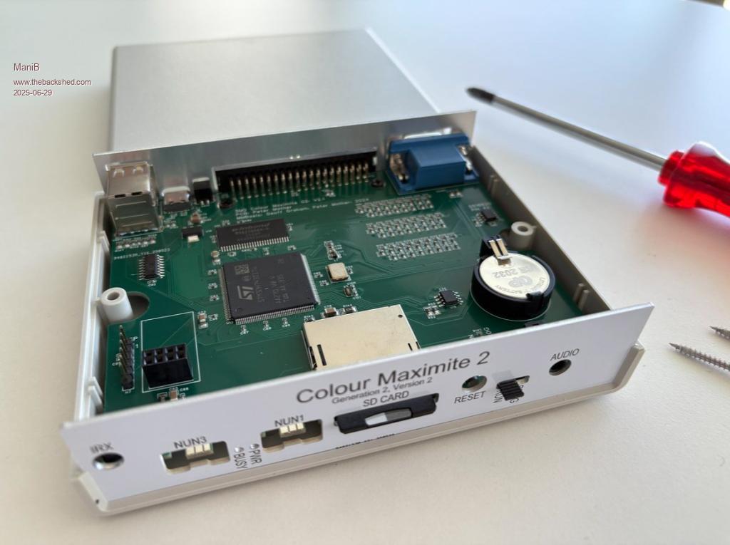

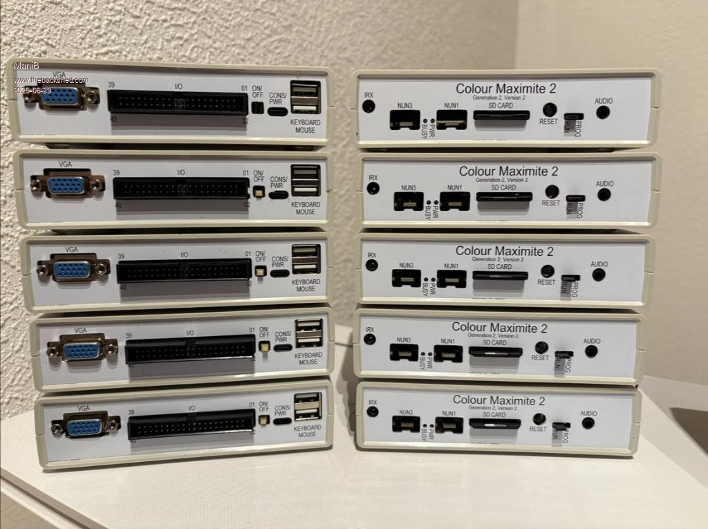

PS: just assembled and shipped ten of the CMM2 G2 V2:
Edited 2025-06-29 08:57 by ManiB
