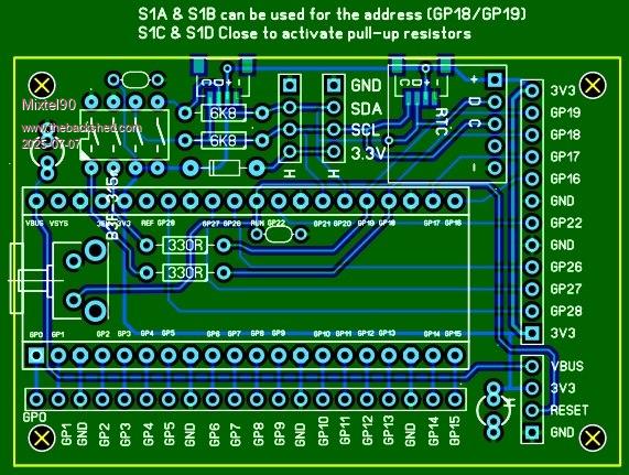

I have an idea....
The QWIIC connectors are optional and are powered from the Pico's supply, which also feeds the pullups. The two 4-pin I2C headers are connected to the remote device's supply. The Pico's 3V3 is fed from a diode from the remote supply so it will be powered by either the USB socket or remotely. This isn't really ideal as there will be volt drop from the external source but I didn't want to have to squeeze a mosfet in!
EDIT:
Still in design. I've just squeezed a CR1220 on board so RTCs with dead batteries can be reused. I don't like throwing them away.  :)  There's also a solder blob link to disconnect the remote 3V3 supply. That might be useful in some cases, like where the supply is from a low current source.

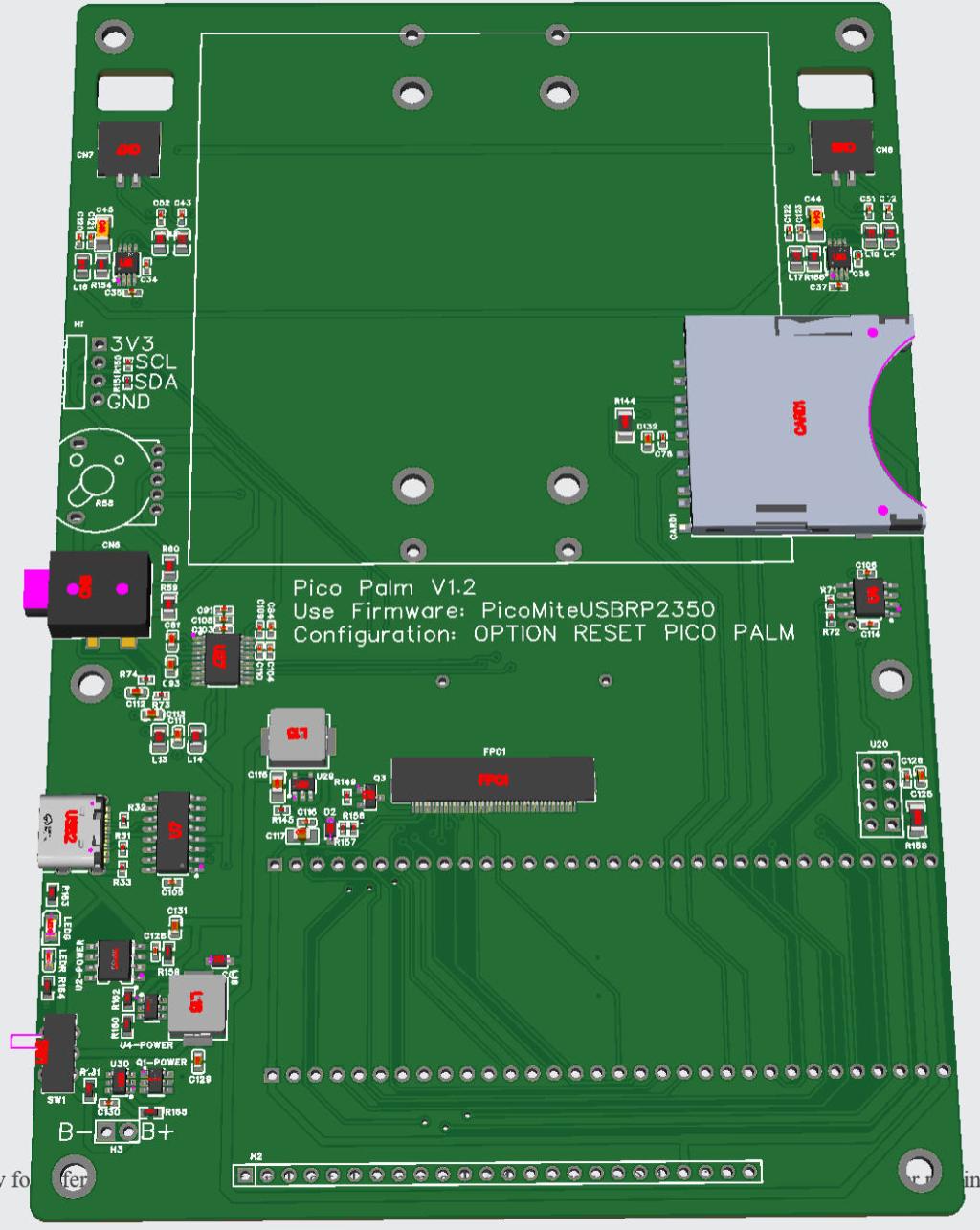

Here is the new layout and revised schematic
87069bec-9ffb-4649-896d-5216e80dc431.pdf
Edited 2025-07-11 03:53 by matherp
Posted: 06:22pm 10 Jul 2025
Looking good there Peter!
Observations (take them, or leave them!).
1: I assume that is still and ESP8266 (from the shape of the connector (schematic quotes ESP32)
2:  to make it easier for the user to adjust the volume when the stereo output (CN6) is in use, ideally the volume control and stereo-out connector should switch positions
3: would it be better the power switch is moved nearer to the ‘top’ of the PCB  I.e. out of the way, rather than right at the bottom where it is more likely to be accidentally pressed
Looking really nice with a great choice of connected parts……
Posts: 12059
Posted: 06:46pm 10 Jul 2025
1: just the legend wrong - thanks - also will be on the bottom of the board
2: Agree but from a layout perspective it wo4rks better keeping the audio signals clean so I'll leave it where it is.
