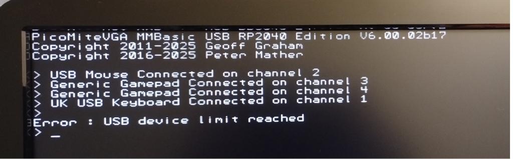

However if I power-cycle the machine with both gamepads attached I get this (apparently harmless) error:

  Quote  However if I power-cycle the machine with both gamepads attached I get this (apparently harmless) error:
That's probably because your keyboard has a spurious second connection. Many of then do but I know not what for.

  matherp said  That's probably because your keyboard has a spurious second connection. Many of then do but I know not what for.
Right, it did report itself as such in earlier betas but it hasn't in recent ones so I thought it was something you'd "fixed", I guess instead it's just something where the behaviour has changed since you've added the enhanced gamepad support.
ChatGPT suggests "Keyboards with dedicated media controls, customizable keys, or additional function keys might present themselves as a separate USB device. This is because these functions can require different protocols or drivers to operate independently of the standard keyboard input."
And the keyboard in question whilst otherwise very low-rent does have multimedia icons printed on some of the keys. Perhaps it is that ?

Posts: 9081
Posted: 03:38pm 10 Mar 2025
One of the reasons for keyboards appearing as more than one USB device is to get n=key rollover at low latency rates. A single USB channel used to be too slow. That's why gamers kept hold of PS2 keyboards (and may still do so for all I know). It caused me a headache when a gaming keyboard wouldn't work on a linux box but would under Windows.
