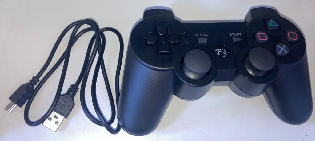

I’ve got one of those knock-offs of the PS3/4 USB controller.
It is recognised without any problems.
'no comment
