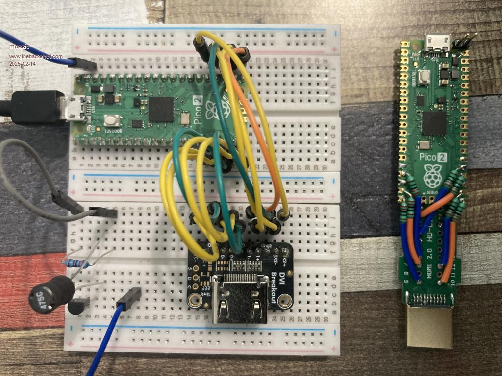

Posted: 07:06am 14 Feb 2025
G'day,
This post was intended to be an update on further testing of DVI/HDMI, but Mr Murphy has put paid to that idea...
Sometimes you just gotta pack it in and have a laugh at everything
So currently working night shift 150km from home, however during a trip home to pick up parts I threw together the device shown at right of the pic below, the mess on the left has been used in most testing to date as a worst case scenario for DVI signals.
Whilst not pretty the new (right) unit plugs straight in to the DVI sink and "should" be more stable.
HOWEVER, even though the PICO2 units came next to each other in the same carrier strip, the new unit will not go past 252mhz reliably, even on the standard RP2350 firmware, it tries but reset loops every few seconds. At 252Mhz it is stable and delivers 640 DVI perfectly. So much for more testing at higher resolutions
This is NOT a winge or complaint, but it does show that we are pushing the PICO pretty hard and even genuine units are not gauranteed to play well all the time.
The fact that DVI/HDMI works at all on this hardware is awesome.
The fact that it'll work at 1280x720 on my breadboard mockup is incredible, just plugged it into the TV in my donga (living unit / cabin) and 1280 works fine, no 5V or 10k resistors required (on this one anyway)
My thanks once again to Geoff, Peter and everyone else involved in getting this little marvel to where it is now
Lyle.
Edited 2025-02-14 17:21 by mozzie
