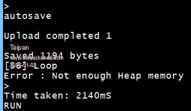

I have just installed the latest WebMite firmware after running Clear Flash and when I upload a 56 line Basic code, I see this error:
I have no idea what it means and it does not seem to affect my simple code.  Sould I continue to ignore that error, or is there something I should do to fix it?
Thanks in advance ...

I can confirm this.It will happen on WebMites that have OPTION WIFI configured and are successfully connected to a router.
It is since the update to AUTOSAVE that fixed an out of memory error if CNTRL+C was used to abort an AUTOSAVE.
If OPTION WIFI is not set or fails to connect you won't get the error.
If you see the error the WIFI connection may not function correctly as its buffers have been released by AUTOSAVE, but not restored, however a CPU RESTART or reboot will restore them.
