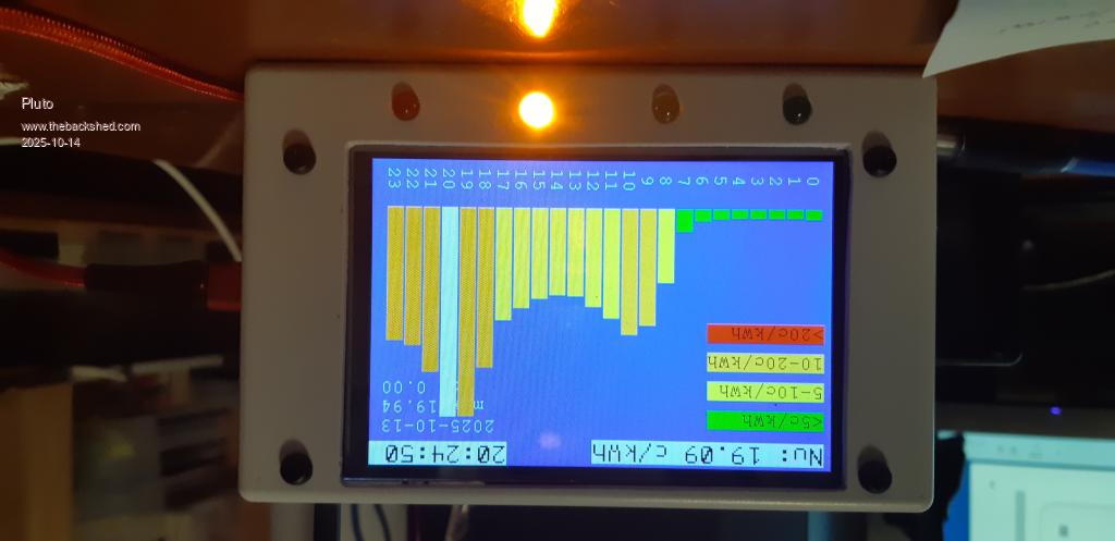

The electricityprice-meter from last year has been in constant operation since Jan 2025. Placed in the kitchen it gives a good and easy overwiew of cheap and expensive hours. Better to heat the sauna when close to 0 c/kWh than at 60 c/kWh.
(Don't understand why is it upside down. Tried to turn it and still...
To make it a bit more complicated the tariffs are now changing each 15 minute.
