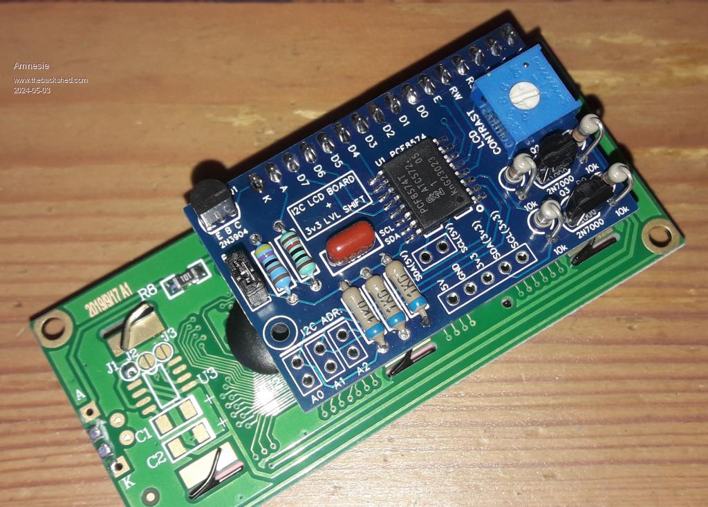

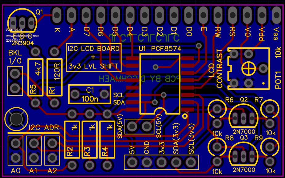

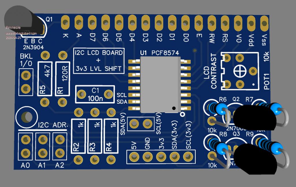

I created a little I2C adapter board with a 3v3 Level Shifter included. As I am aware, there are no such boards with a 3v3 Shifter available. Maybe someone can use this too.
It has the option to use also normal 5V SDA & SCL.
And the Gerbers:
Gerber_x_mobile_miniX_lcd_i2c_connector_public_2024-04-24.zip
Greetings
Daniel
Edited 2024-04-25 03:46 by Amnesie

Nice work Daniel
Where did you get the circuit and is it available.
One never knows when it may be useful.
Chris K

Hello Chris,

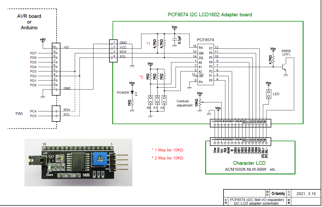

the circuit is adapted from the original:
But I have added a level shifter for 3v3 operation, since the picoMite demands 3v3.
There is also an additional resistor "R1" (120R) which can be adjusted to your likings, since I found the original is way too bright (and if you don't use PWM this can be a good starting point).
Main focus (besides 3v3) was to get rid of all SMD package components... except the PCF8574 of course.
I've ordered some @ JLC yesterday and will report back if everything works. But I tripple checked the layout, should be fine.
Greetings
Daniel

Hello Jan,
this is problematic if I understand you correctly. In fact this was my first idea to work around the level shifter too. BUT:
If you look at the datasheet carefully you find:
"VIH High-level input voltage 0.7 × VCC (min) VCC + 0.5" (max) This means if you feeding the PCF8574 with Vcc 5V but pulling the SDA & SCL on 3v3 we don't match those
requirements:
Since: 0.7 * 5V = 3,5 which is minimum needed to recognize it safely as HIGH, but we only have 3,3V. So your attempt may work (or in fact does work since you've tested it) but this relies more on luck / tolerances of the individual chip and manufacturer.
I also thought about this, but came to conclusion that it isn't good design practise.
And more over: think of the case you don't have good 3,3 Volts but even less... way more out of specs...
Don't get me wrong, I believe that it works for you... But it isn't safe. And by a fresh design I also got rid of all (other) SMD components

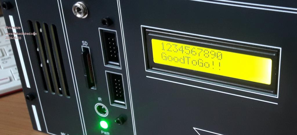

Hello I want to report back that my pcb is fully working, so if you want to order your own, you can do so with the attached gerbers in my initial post (see above).
I've ordered an original NXP PCF8574T (no china clones!) and even the datasheet says 100 kHz it works with system i2c @ 400kHz (take this just as an information).

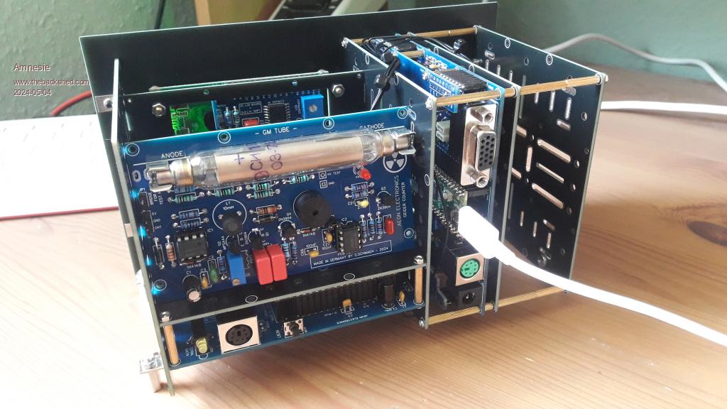

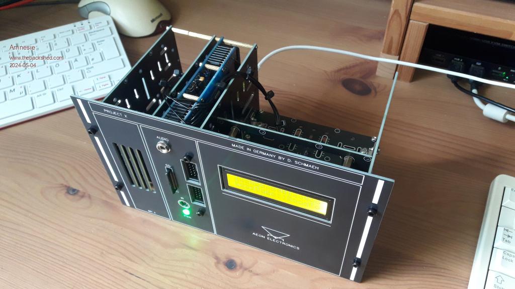

Anyways, here are some pictures of my project with the LCD:
Greetings
Daniel
Edited 2024-05-03 22:46 by Amnesie

Nice looking project !
What is it ? IR sensor ? Is it a CMM1 or CMM2 ?
Amnesie
Joined: 30/06/2020
Posts: 763
Posted: 02:05pm 03 May 2024
Hello,
it's a a complete adaptive "boot to basic"  standalone computer running PicoMiteVGA with built in speaker & amp, I2c-display, IR and PS/2 mouse, which is running on a separate raspberry pi pico (to convert ps/2 to serial). On the back are expansion slots for additional modules like my geiger counter.
It is designed to be:
- A development environment (GPIO on the front + dust cover)
- A fully stand-alone boot to basic with VGA and mouse
- A basis for any project x you can imagine... (a lot of space left inside for modules)
This way I have a basis for most of my projects without designing a whole new case every time.
it is all made of PCB material (excluding the steel enclsoure not in the picture) and
highly adaptive due to the vast mounting options.

Posts: 6050
Posted: 06:51pm 03 May 2024
Aha
Sort of "box of pandorra" It has everything in a nice compact for.
So much different from my system. I have a basic PicoMiteVGA unit, and some breadboards and separate pico's..
Oh... and a Game*Mite....
