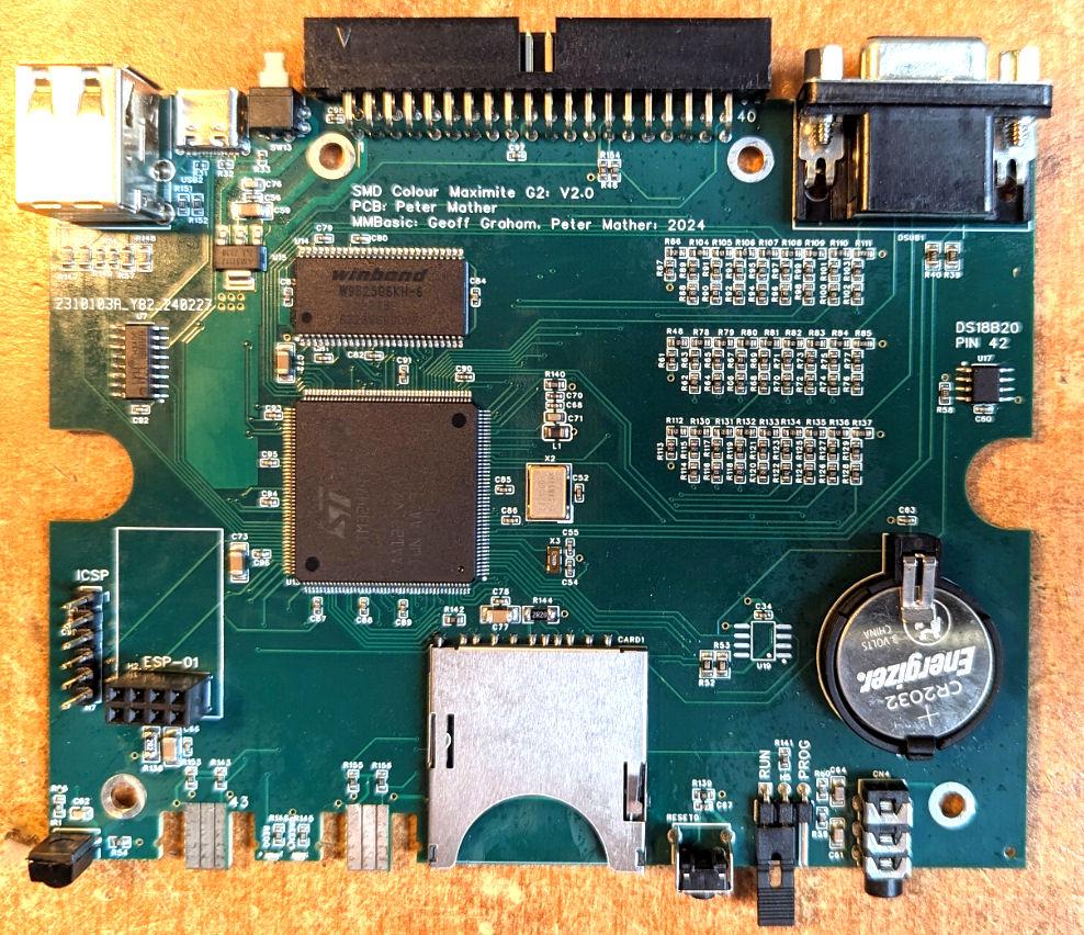

Hi Peter,
- no RTC
- solder mask on the rightmost contact for the nunchuck
- R144 seems retrofit (is soldering okay ?) feels like it has solder on the part, but maybe not on the pads. -or- the footprint is too small. Similar to the 2.2 ohm resistor at the ESP-01.
Posts: 12069
Posted: 01:36pm 06 Mar 2024
Didn't ask for the RTC as they are expensive and I wanted to minimise cost if there might have been issues.
Nunchuk connectors should be fine, just the way I laid it out
R144, R138, U7, U17 + all through hole were soldered by me - extended range parts that I had stock so omitted from the build
Video beautifully clean and audio no discernible noise

RTC now added and working

  matherp said  The boards have arrived and program and boot up perfectly. Once I've finished testing everything I'll post the gerbers
Looks very neat and tidy, Peter.
I was about to order more G2's, but I am going to wait till you have tested and are happy with this new layout, then I can just order these - and not have to do anything other then plop them in the case, really.
In your ZIP/Github of the gerbers etc, can you please include your front/rear panel files, so that I can order these new ones to suit the new board.
Edited 2024-03-07 08:01 by Grogster

Posted: 10:55pm 25 Mar 2024
  matherp said  The great news is the price £135 for 5 boards (not including postage and tax) fully completed as you see here - nothing left to solder and ready to pop into a box
That breaks down to US$170 + DHL(usually about US$40 or so) and any import duty, so US$42 per unit + international shipping to send each unit off to wherever it needs to go.
That is usually about US$15 for tracked airmail + a small profit margin for me to make it worth the effort, so I'd be setting my new price for the new all-in-one PCB at around US$80-85 all-up, including case, front/rear panels, fully assembled board and international shipping.  Pretty much HALF the price of the current ones, cos all that time soldering on the connectors is no longer an issue.
This new layout is an excellent idea, as some customers still moan about the price of the current one, so if we can effectively HALF the price more or less, that should make them much more desirable then they are now.
That's the estimate that I am working from for now, anyway.
