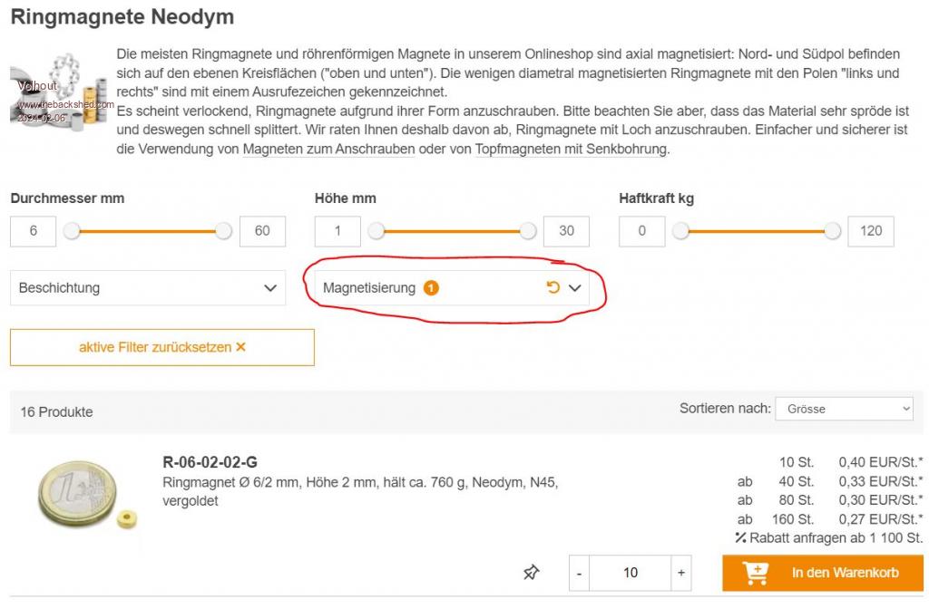

But I still would suggest the hall sensor with (2) magnets in a dusty environment, or a single magnet on top of the shaft (in which case it must be positioned correct to create a field change).
There are small 3mm diameter "supermagnete" that should do the job with some epoxy glue.
where to buy
You can also buy "ring magnet" with axial magnetization, that you can simply "glue" around the shaft, so you have no unbalance. The picture below shows where to select axial magetisation, and shows the smallest of them, but there are MUCH larger ones in this list.

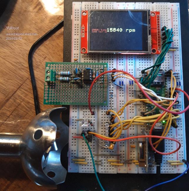

Posts: 6199
Posted: 08:05am 13 Feb 2024
Hi OA47,

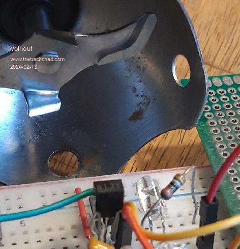

I tested it, and it works amazingly good.
I used a IR LED from an old IR remote control, and connected it to a 38kHz PWM output through a 330ohm resistor, You do not need to drive the LED hard, since it is designed for 7 meter (remote to TV) range, and we need only few cm.
I used a (old) 5V IR sensor from a set top box. The output of these sensors is "open drain", so I added a 10k resistor to +3.3V from it's output.
I faced both IR LED (transparent 5mm LED in below photo) and IR sensor (the small black item) roughly towards the blades of a kitchen blender. Since the IR sensor has automatic gain control and AM demodulation, it will see the blades nicely.
Using the blender turbo speed, I could achieve 15800 rpm. See below simple test program. My LED is connected to GP10 (PWM5A), the frequency is measured at GP9.
Ignore the breadboard, it has circuits to debug PIO, RTCm, mains monitor and many more. I just added this for test.
'test for rpm measurement
SetPin gp10,pwm   '38kHz out
SetPin gp9,fin    'pulse input from IR receiver
'generate IR stream
PWM 5,38000,50
'freq to rpm
blades=2
conversion=60/blades
 r=Pin(gp9)*conversion
 Text 100,100,Space$(12),,4,2
 Text 100,100,Str$(r,4,0)+" rpm",,4,2,RGB(yellow)
 Pause 200
P.S. Most TV remote IR LED's are designed for 500mA peak. We only need 5mA or so for this short distance.

Posts: 6199
Posted: 09:30am 13 Feb 2024
OA47,
To make this work, you have to operate the IR receiver in it’s AGC range. Too much IR at its input will clip the AGC and stop the demodulator from working.
Since the IR receivers are very sensitive, the guideline should be”less IR is better”.
Edited 2024-02-13 19:32 by Volhout
