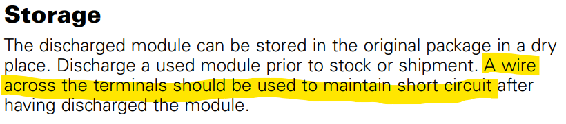

"Hey, when you see our intern, just have him stick this piece of wire across those terminals"
Posts: 9081
Posted: 09:14am 16 Jan 2024
Those are beautifully scary. :)  A good idea to be able to keep a check on the temperatures without going near the place!

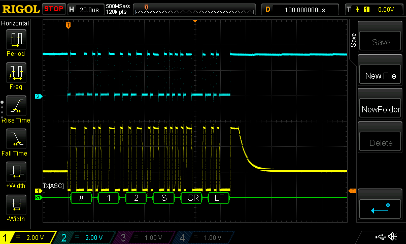

I finally got a chance to get some THVD 1406 Rs-485 transceiver IC's and tried doing some simple serial transmit scope shots...
The upper blue trace is the Tx output and the yellow is the A output and is unloaded but in phase... After some testing, I noticed you have to run the baud rate at 460800 or higher or the transmitter section will time out and corrupt the bit stream...
Will be testing 2 way communication during the week...
