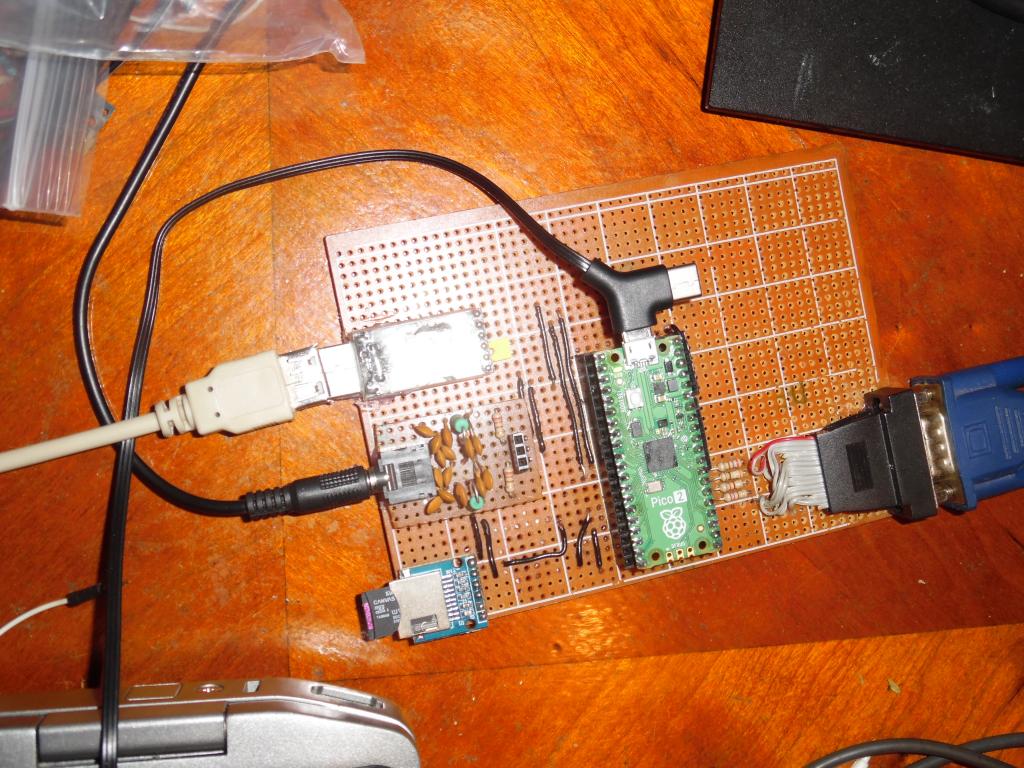

Posted: 11:27pm 30 Aug 2024
it's technically gone tits up.
picomite 2040,vga 2040,usb pico2040, usb vga 2o40 and all pico2 versions.
I lost the thread'
the usb serial to ttl is a male socket and plugging into a usb2male to female lead unreliable.
looking for female usb serial to ttl
I only got bread board vga pico. solder stripboard tomorrow

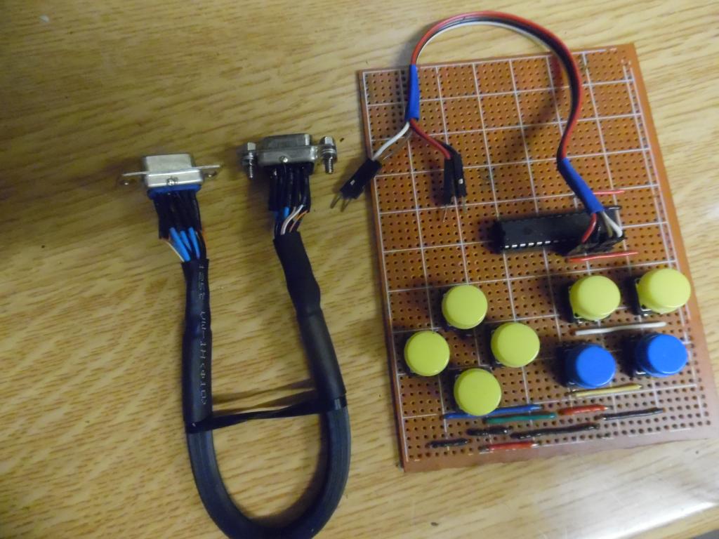

got vga sockets and gonna use mcp23017 i2c 16 pin expander for key input.
the usb vga is nice but serial usb to ttl is 5v power and all my connections fail.
thing is do I use a keyboard in a program? no. so why bother with usb ?
gonna do a nice stripboard normal vga tomorrow. got a pack of 5 inductors for sound filter,3 left. veecad handy. I'll be using pico blue usb c. seem ok
these vga sockets are <£2 for 2
Posted: 12:29am 31 Aug 2024
the female to male serial usb to ttl is a pain.drops out and tried a few
Posted: 09:55pm 31 Aug 2024
I forgot how to do sound .doh
Posted: 10:08pm 31 Aug 2024
v13 working if I comment playmod. Twills less joy-error pc3 or begin with p. thanks anyway, I'll retry.
usb vga pico2... so interesting 2040 stuff on pico2
with usb then 5v from serial ttl to pin 40 5v sys. I stuck it into socket 40 not soldered hence my problems. soldered and stable.. no windows dinky ding dinky dong.
haven't tried i2c buttons cos ship action is too slow

I2C controllers are fast enough for this game.

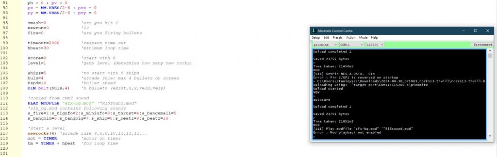

Posted: 03:27pm 01 Sep 2024
rocks13.bas
> option list
PicoMiteVGA MMBasic USB Edition  6.00.00b2
OPTION AUTORUN  ON
OPTION FLASH SIZE 4194304
OPTION COLOURCODE ON
OPTION KEYBOARD UK
OPTION CPUSPEED (KHz) 378000
OPTION SDCARD GP13, GP10, GP11, GP12
OPTION AUDIO GP0,GP1', ON PWM CHANNEL 0
> b:
> files
B:/
19:26 01-08-2024      68506  RISsound.mod
16:48 30-08-2024      44556  sfx-bg.mod
22:39 29-03-2023   55342378  t1.wav
21:11 02-04-2023   65642368  t2.wav
0 directories, 4 files
> run
[105] Play modfile "sfx-bg.mod" '"RISsound.mod"
Error : Mod playback not enabled
Dunno what's wrong. I did have sound with 2040. maybe pico2 problem.
Graphics are great. this is pico2 usb vga.. someone's got to test it. regards, stan
Posted: 04:08pm 01 Sep 2024
Stan, I think you must have forgotten, if you are going to use PLAY MOD then you have always had to preallocate some of the flash to it, e.g. at the prompt:
OPTION MODBUFF ENABLE 192
WARNING! this will erase the contents of A: drive.
Good luck,
Posted: 04:58pm 01 Sep 2024
This will erase everything in flash including the A: drive - are you sure (Y/N) ?
Error : Could not find the file
> UK USB Keyboard Connected on channel 1
> Generic Gamepad Connected on channel 2
> run
> option list
OPTION AUTORUN  ON
OPTION KEYBOARD UK
> C:\Users\stanley555\Downloads\2024-08-30_055145_rocks13\rocks13.bas
Uploading using:  'target port\COM11:115200 s\picomite
Upload started
NEW
autosave
Upload completed 1
Saved 22332 bytes
Time taken: 20525mS
RUN
it was   play modfile "b:\sfx-bg.mod" '"RISsound.mod"
now it plays and sound.. got level 3
