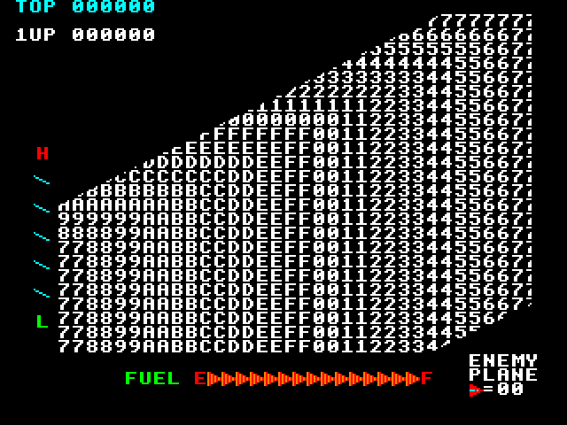

Possibly a New Project for 2024
some Code to test it out
the scroling Text should be replaced by Tile Based Graphic
'Isometric Scroll test
MODE 2:Font 9
nr=0
Dim cl(15):cl(0)=0:Restore colr:For f=1 To 15:Read cl(f):Next
FRAMEBUFFER layer 2
FRAMEBUFFER write l
create_layer
t=Timer
FRAMEBUFFER write n
For n=1 To 1000
 k$=String$(15,Hex$(nr,1)):m$=Hex$(nr,1)+Hex$(nr,1)
 Text 200,0,k$
 For f=8 To 160 Step 8:Text 304,f,m$:Next
 For f=1 To 8:Sprite scroll -2,-1:Next :Inc nr:nr=nr And 15
 Box 0,0,16,240,,0,0:Box 0,232,320,8,,0,0
Next
Print Timer-t

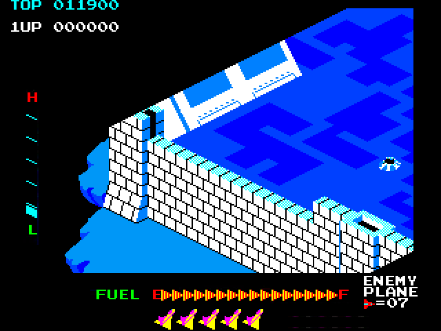

then it could look like this on Pico
'no comment
Posts: 6199
Posted: 11:20am 03 Jan 2024
That already looks very much like zaxxon.

Martin H.
Joined: 04/06/2022
Posts: 1573
Posted: 01:08pm 03 Jan 2024
  Volhout said  That already looks very much like zaxxon.
I need to watch some demo movies, since I never owned an msx, so never played it.
This isn't a MSX thing, you might try the Arcade Version
'no comment
