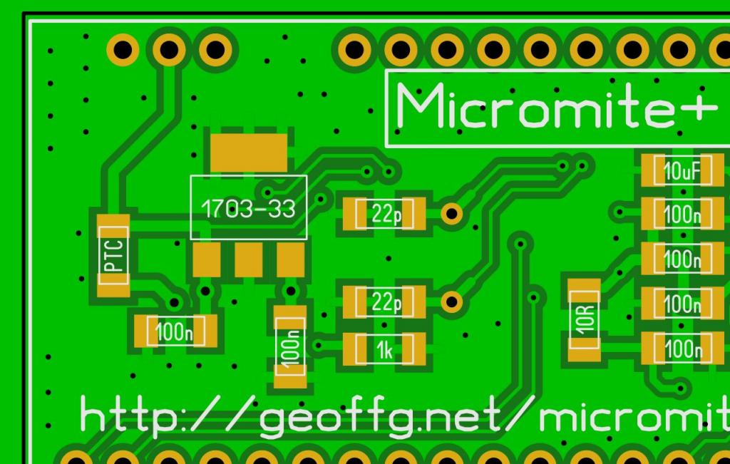

On the bottom of the board, to the left of the 3v3 regulator, there is a part labelled PTC - remove that, then you can connect an external 5v supply to the 5v pin at the edge of the PCB, and also still connect the USB cable, as removing the PTC, effectively cuts the link to the USB power.
See image below.  You WON'T be able to power the board with the USB cable if that is done, so you will ALWAYS need external power.
You can replace the PTC with a SOD123 SMD power diode if you prefer - cathode to the 5v pin on the edge of the board.  That effectively installs a diode-gate so you can use either external or USB power.  That was how the later boards were setup.

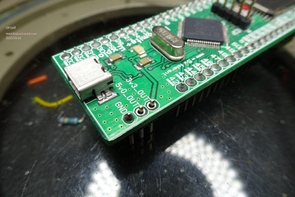

Well, this afternoon I took the advice to the workbench and removed the polyswitch.  Result: a dead Explore 64!  Power connected, USB line - all dead as a dodo.  Frustrated, I started working around things with a meter; power line supply okay, USB fully functional with a Picomite etc.  Power getting to the VCC 5v pin and then...a closer look at the Explore 64 and this is what I found:
This was a commercially-assembled Explore 64 bought as one of several units when it was in its heyday.  The assembly line had somehow missed out soldering the power pins - both 3.3 out and the 5V in/out pins.  Caused me half an hour of head-scratching.

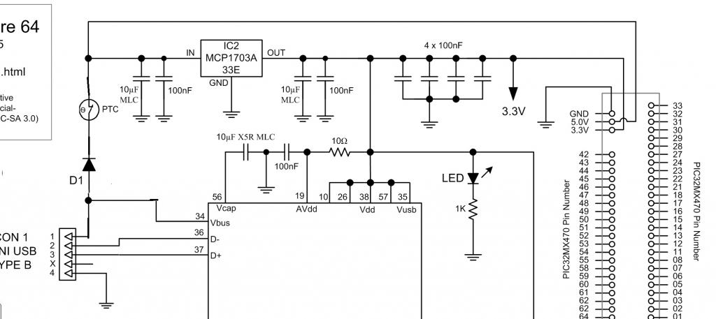

Explore64 1B for others.zip
Does this help?
Posts: 9246
Posted: 06:58am 28 Sep 2023
Oh, so the 1B is already protected by an invisible D1, :)  It's on the schematic but I can't spot it on the PCB pictures. Do I need to clean my glasses?
(It only appeared on Version 1C, just in case someone is looking).
Edited 2023-09-28 17:10 by Mixtel90
Posts: 6631
Posted: 08:05am 28 Sep 2023
No, The diode is a mod I did to bring it up to the 1C capability.
I should have explained that!
