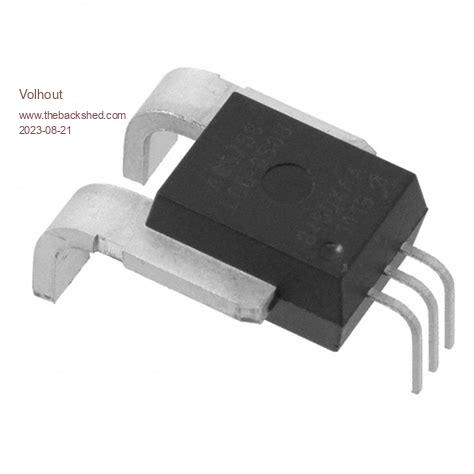

Posted: 05:11am 21 Aug 2023
The hall type is plenty avalable in PCB (chip) form up to 100A.

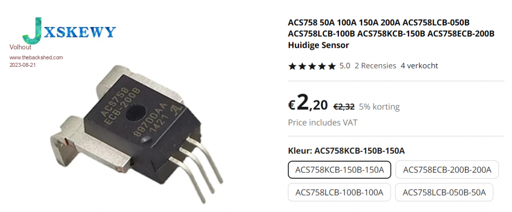

Posts: 6200
Posted: 01:35pm 21 Aug 2023
If you make a PCB anyway, this is cheaper...

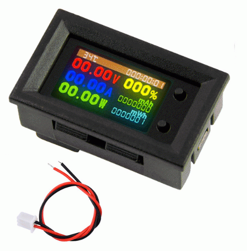

Posted: 03:08pm 21 Aug 2023
I have found this to be a great little device: VoltAmmeter display  .
Now if there was just a convenient way to query it to get a reading via serial.

Posts: 6200
Posted: 04:14pm 21 Aug 2023
The ACS758 series had build in galvanic isolation, so it can directly be used to measure high side.
In the TBS forum on electronics it is used to measure inside solar systems and high power convertors.
