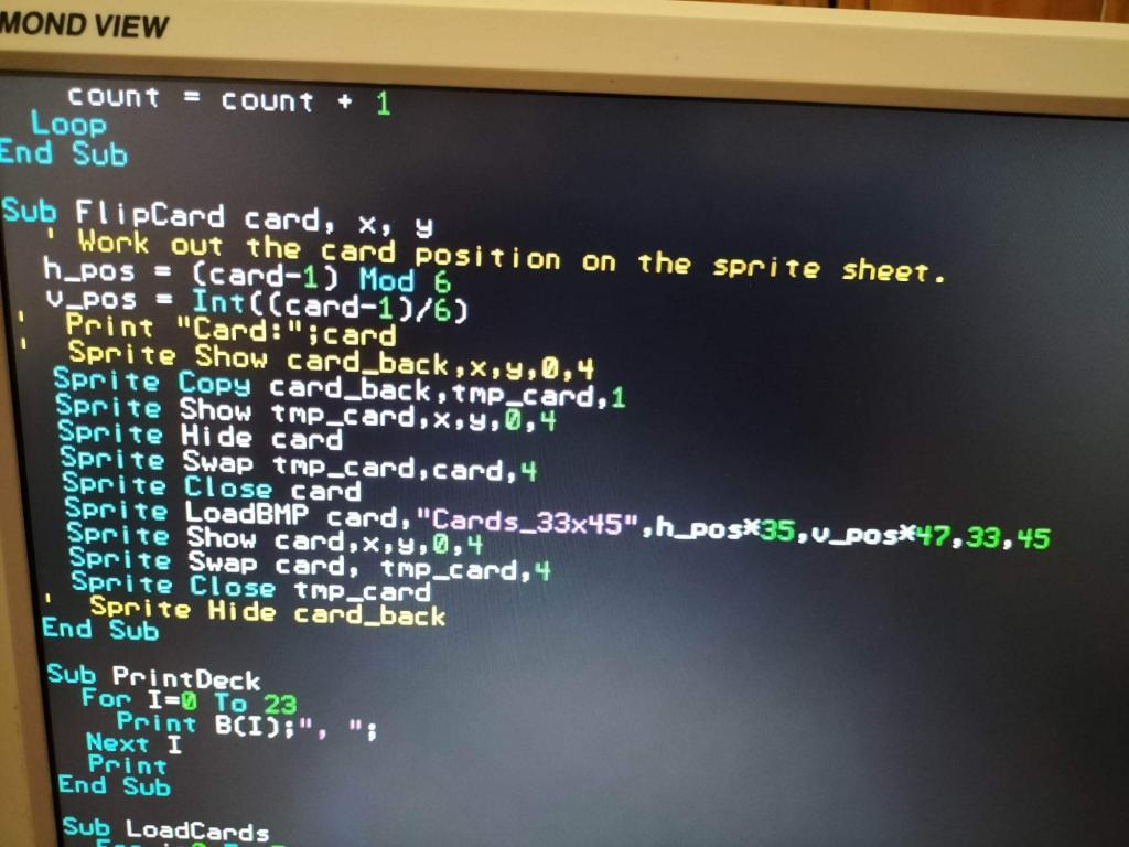

To try and speed it up a bit, and not read from the SD card twice, I decided to SPRITE Copy tmp from my existing card back sprite, as I do when creating and dealing all the other cards.
So it actually looks like this:
SPRITE Copy back,tmp ' Copy card back to tmp sprite
SPRITE Swap card,tmp,4
SPRITE Close card
SPRITE LoadBmp card ' Card face value
SPRITE Swap tmp,card,4
SPRITE Close tmp

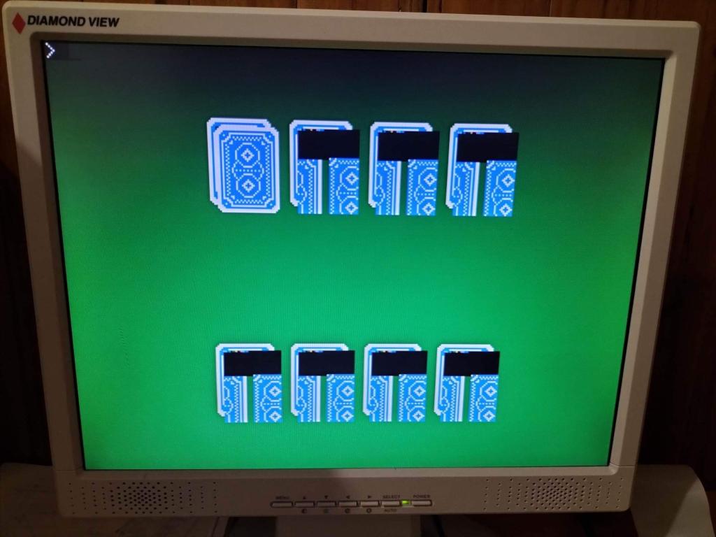

Tweet showing sprite error.
As you can see, the speed has not decreased noticeably, and the black is no longer transparent.  (Thanks Peter) But the sprite image data is being corrupted as I move it across the screen, but always after it has worked successfully four times.

Sprite Copy card_back,tmp_card
Sprite Show tmp_card
Sprite Hide card
Sprite Swap tmp_card,card
Sprite Close card
Sprite LoadBMP card
Sprite Show card
Sprite Swap card,tmp_card
Sprite Close tmp_card
To achieve this code I had to rearrange the order of things to eliminate each error that occurred in turn.
