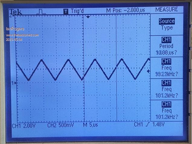

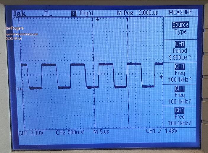

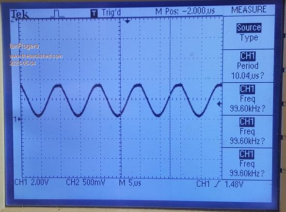

All working!  I need to trim here and there
Tested to 100Khz  for Sine, triangle and square
Sine..
Triangle..
Square..
The square wave starts to distort around 500Khz.
The onboard amp distorts the triangle and sine around 3V3 so the level maxes out at 56.
I just need to set max level (100%) to that figure..
Apart from that, I'm very happy..
Cheers for the MMBasic and the DDSprogram Geoff, and cheers to Peter for the picomite..
