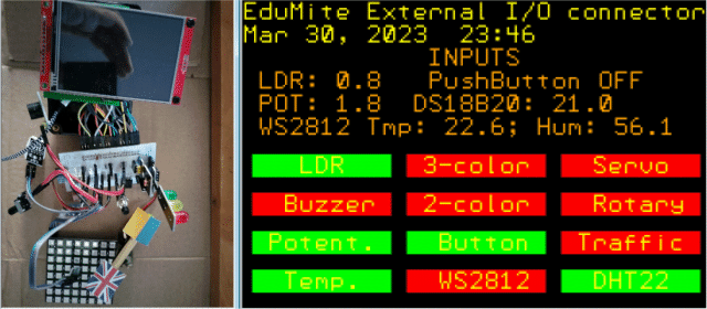

A Possible EduMite with LCD
This is a working mockup for a possible EduMite. It has an ILI9488 LCD display, and 18 available I/O pins. It has DS18B20, DHT22, LDR, potentiometer, and pushbutton sensors, and for outputs, a traffic light module, an RGB LED module, a red/green LED module, a buzzer, a 64-LED WS2812 module, and a servo. Two additional pins are available for a PS/2 keyboard (which could make it a stand-alone unit with the built-in editor).
The menu system shown on the LCD lets you turn on any or all of the I/O devices. A SETTICK enables the sensors to be updated every 100 milliseconds.
EduMite Youtube Video
This mockup was cobbled together using an ESP32 PCB which had an SPI LCD interface, and a 20x2 PCB I had made for interfacing "37-in-1" kit sensor and output modules.
It uses female headers and dupont wires to the sensors/outputs, so probably wouldn't be suitable for 12-year-olds and younger, but 14-year-olds would probably be ok.
I have laid out the schematic with EasyEDA, and I have to say, after using EagleCAD for years, EasyEDA lives up to its name. I'll send off for the PCBs when I finish the layout.
Most of the "37-in-one" kit modules could be plugged in (not simultaneously, of course).
I will also work on a "hat" pcb for Mick's PicoMiteVGA Mini 6.0, which has 12 I/Os on its header. In theory, I2C/RTC and SD SPI pins could also be available.
EduMite.zip

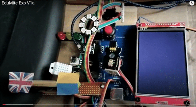

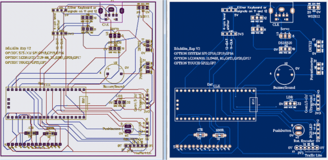

Here's an EduMite Experimenter PCB (Version 2 with, I hope, keyboard support):
It has a 480x320 ILI9488 LCD and rotary encoder, potentiometer, LDR, servo, R/G LED, RYG Traffic light module (or RGB LED), DS18B20, DHT22, WS2812, pushbutton, buzzer.
Here's a 4-minute, 20-second youtube video: EduMite_Exp
Here's the code being run in the Youtube video: EduMite.zip
And here are Gerbers for Version 2: EduMite V2a_2023-04-30 Gerber.zip
(Version 1 is shown in the video, but I had used an incorrect PS/2 keyboard layout. This version corrects that using this level-shifter: 3V3-to-5V Level Shifter . I also added header pin pads for the keyboard pins--11 & 12--so other sensor/switch modules can be used in case the keyboard isn't connected.)
Of course, other modules from the 37-in-1 kits and elsewhere can be used instead of the ones named on the PCB. For instance, a second traffic light module can be plugged in with Dupont wires instead of the rotary encoder so that code for two directions of an intersection could be coded.
With a working keyboard, the PCB could be completely stand-alone with the LCD as console.

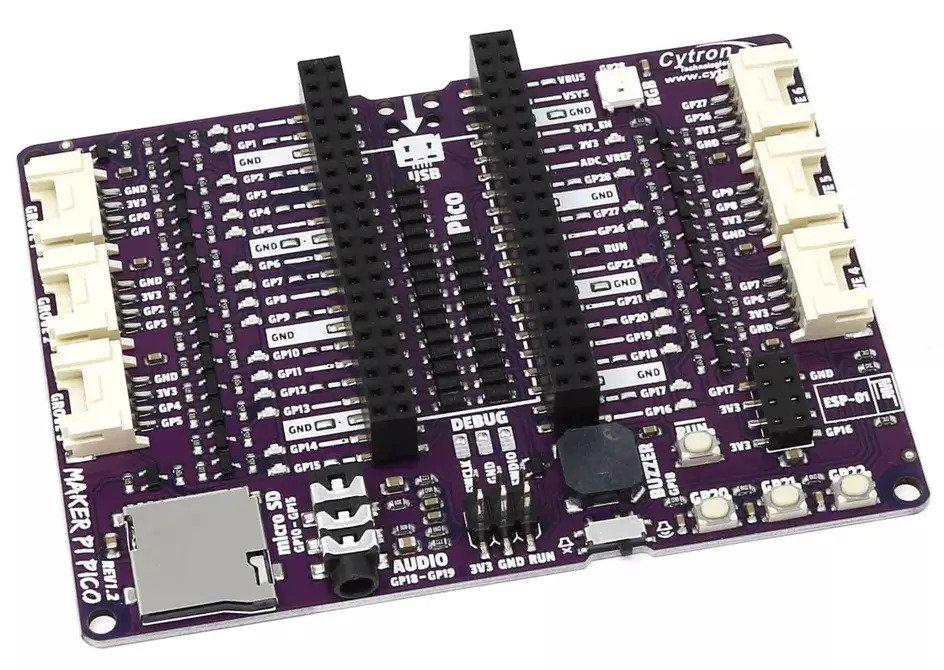

The Base module I would propose is this (GBP8.70)

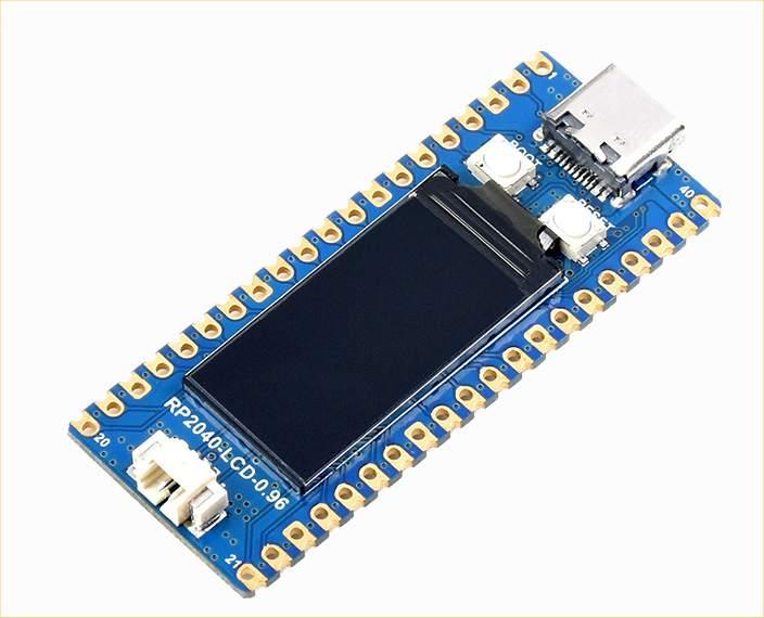

This would be used with a standard Pico or if a display is required with this
which is a RP2040 with an integrated 0.96inch 160×80 pixels 65K colour IPS LCD display (USD13.99 from Waveshare)
We have now already got SDcard, Audio filter and jack, 3 user switches, WS2812 LED, 6 GROVE connectors and LEDs on every pin so all I/O can be monitored.
The key is the GROVE connectors. Cables are cheaply available GROVE-GROVE, GROVE-STEMMA, GROVE-QWIC
This then open up a huge array of peripherals
Grove: Relay, GPS, SSD1306, Buzzer, Accelerometer, ESP8266, Distance, LED Bar, IR, Vibration, etc.....
Search for Grove on thepihut.com
STEMMA and QWIC
Google "ADAFRUIT STEMMA"
If necessary the main board could be protected with a polycarbonate sheet top and bottom but at only just over GBP10 for the board and Pico is it even worth it?
I can't design anything to compete with the price and variety of the offerings that are now available in this space and, of course, all of them can be supported from MMBasic

I don't think there's a right or wrong approach - or an approach that's one size fits all for that matter.
There's no way young children could cope with a Maker Pi Pico, I don't think. Everything that gets plugged in (if it goes in the right holes and isn't forced in the wrong way round) will be pulled out by its wires. TBH I doubt if many could manage Dupont connectors. And someone *will* cross connect things that shouldn't be cross-connected and break stuff. Yes, it's cheap, but having to replace 20 or so boards per term isn't. And that's not to mention the Picos.
There is a reason why school equipment has traditionally been connected using 4mm plugs and sockets. They are virtually indestructible. I have three ex-school "Labpack" power supplies here. They are built like tanks (and are almost as heavy!). They have lasted many years, never mind terms, though but I had to replace the circuit breaker on one.
The older kids will be fine with a Maker Pi Pico setup - and may already be into Arduinos at home. They'll know how to work with Duponts and have more manual dexterity and less propensity to shove bits of chewed biscuit into the sockets ...
