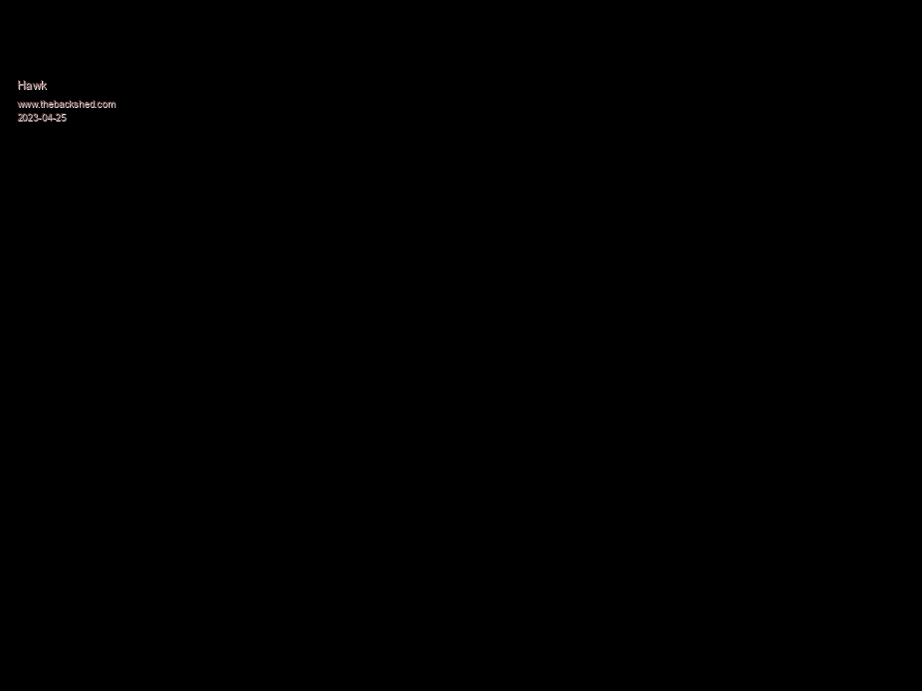

OK so I finally finished my Silicon Chip kit build.
It was super easy, right up to the point where they left the 2N7000s out of the kit.  At first I wondered why the keyboard wasn't working.  I worried that my power supply wasn't big enough.  Then I noticed the empty holes!  Luckily I had some on hand from another project.
Anyway, here it is all setup and operational.
No sound (of course) and I haven't configured the SD card yet.  Time to learn how this baby works!
One of the first things that I did notice is that the fonts are different sizes in Mode 2.  The test printed from the program is one size, but the text typed in at the command prompt is a larger size.  That was unexpected.

Mode 1 is 640 x 480 and Mode 2 is effectively 320 x 240 so the console font is double size. Console font size can be adjusted.
OPTION LCDPANEL CONSOLE [font [, fc [,bc]]]
Configures the VGA display
The arguments are optional but if supplied must be numbers for use as the console output. , 'font' is the default font, 'fc' is the default foreground colour, 'bc' is the default background colour.
The default (after first flashing the firmware) is:
OPTION LCDPANEL CONSOLE 1, RGB(white), RGB(black)

Thanks Phil, I knew it could be changed, I just didn't expect the font from the output of the program to be different from the console font.  It certainly wasn't for Mode 1.  These are the nuances that I will get to know.
I'm very excited to be programming on the actual hardware, and look forward to seeing what I can create.  The final build I wish to make will have stereo audio, RTC, controllers and hopefully serial port with hardware flow control.  Fonts are probably the least of my worries. ;^)
