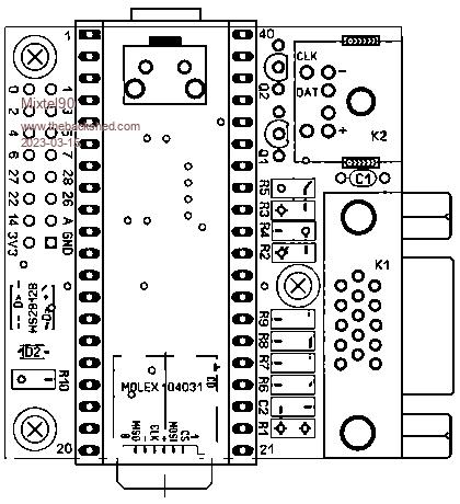

I've been playing with the 2X2 design and come up with the 2X2P, which uses a normal plug-in PicoMite rather than surface mounting it. It's slightly different in a few ways, it might be of interest if someone is looking for a pretty minimal VGA board. The main thing missing is a RTC, but not everyone wants one and there is enough IO there.
2X2P circuit.pdf
