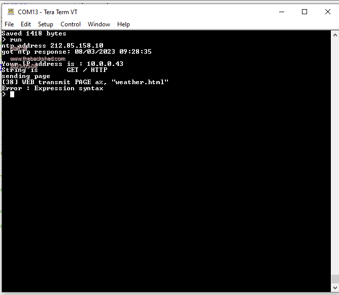

Can someone tell me what is wrong with this ?
I also have the file "first.html" in A: and if I substitute the word first for weather in the problem line it works OK ?
palcal
Joined: 12/10/2011
Posts: 2053
Posted: 02:46am 08 Mar 2023
Getting somewhere I thought the error was in the line
WEB transmit PAGE a%,"weather.html"
but it is in the file "weather.html"
I've jumped the gun and used <br>
and <pre> and forgot one of the <
Edit. I also edited it in Libra Office and although I saved it as a HTML document in didn't open properly, so I edited it in Notepad and selected All Files and it now works as expected.

  palcal said  error was in the file "weather.html"
Congrats on figuring it out. Errors in HTML can be tough to catch.
