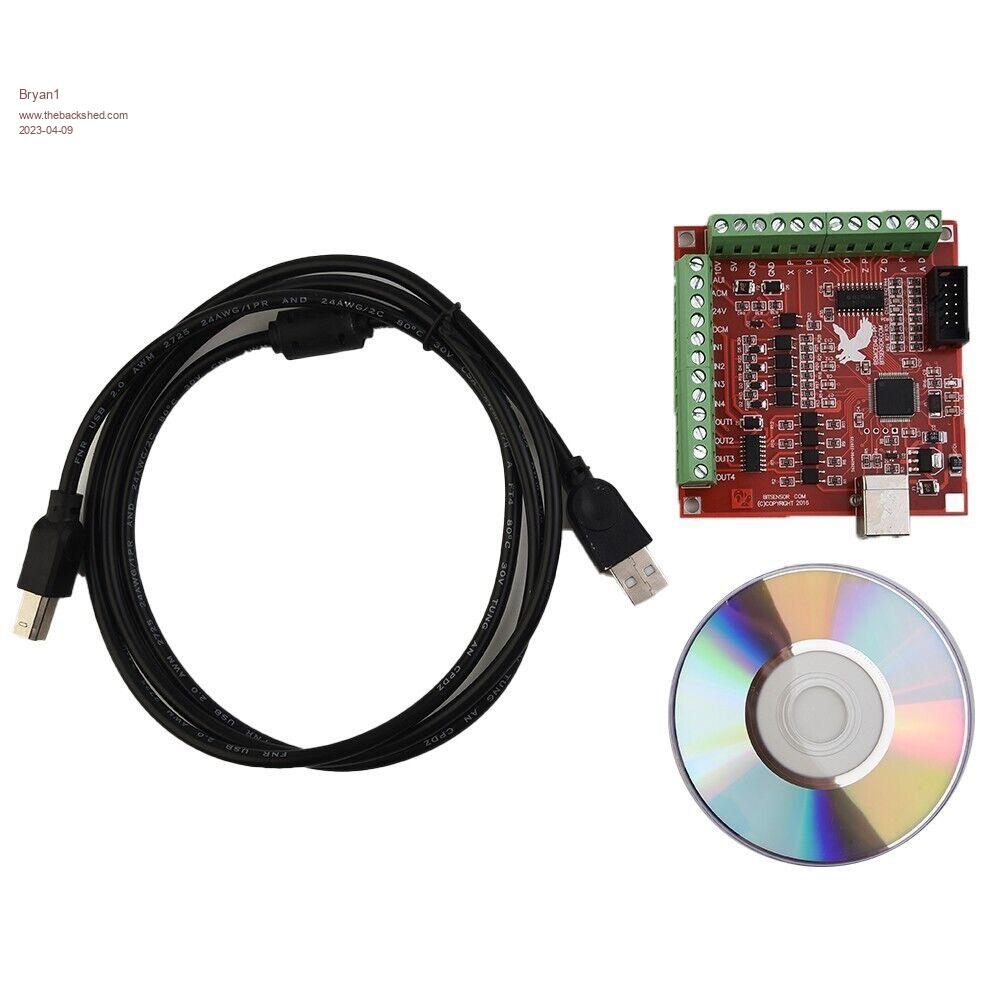

Posted: 11:15pm 08 Apr 2023
This is the USB controller I got
also got 3 off DM556 micro stepper boards, now as these boards have enable pins and the controller board doesn't I can wire it up to 12 volts and use a toggle switch.
This PCI board should be here later in the week so I'm going to try that first.
Cheers Bryan
