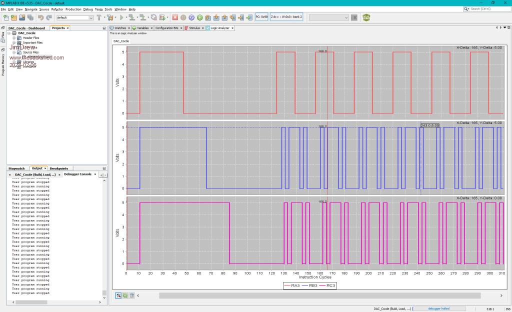

I have just written a short program that exercises MOVIW FSR--/++ without any interrupts, subroutines, and minimal initialisation. Straight line code if you will.
It runs from the internal oscillator at 32MHz, so needs no external components at all.
It ran the same at 4MHz and 16MHz too.
MOVIW Test.zip
Enigmatically, it behaves to spec.
The code reads a toggling table of just 4 o/p states in a table in GPR Bank 0, running up and down the table manually.
There are 3 o/ps :-
RA3 - 'scope trigger,
RB3 - a straight switched output,
RC3 - a copy of RB3, but using MOVIW recovered data from Bank 0.
Expected waveforms are shown in the file.
