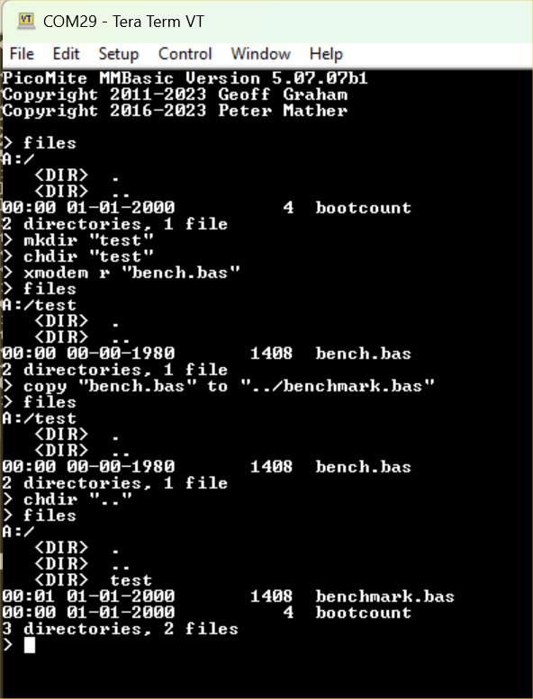

> chdir "test"
Error : Could not find the path
> chdir"Test"
> rmdir "Test"
> files
A:/
  <DIR>  .
  <DIR>  ..
00:00 01-01-2000          4  bootcount
2 directories, 1 file
> mkdir "test"
> files
A:/
  <DIR>  .
  <DIR>  ..
  <DIR>  test
3 directories, 1 file
> chdir "test"
picomite with latest beta
drive a:
CHDIR only works with directory name in lower case.
Other commands appear to work normally.

Posted: 01:43am 15 Jan 2023
My post was to confirm the bug.
On the flash drive, you cannot CHDIR into a folder with any upper case letters in the name.
This is a bug.
The SDcard is OK.
I am not sure when it appeared. All my testing on the new flash system was in lower case.
To use the flash drive, keep your folders in lower case until the problem is resolved.
When updating firmware, the existing file system and flash slots are usually preserved but not always so backups are strongly recommended.

Posted: 08:21am 15 Jan 2023
The LittleFS file system is case sensitive (like linux). This is documented in the manual. However, I don't understand why CHDIR seems to have a particular problem - I'll look at it - perhaps I'm inadvertently converting the supplied directory name to lower case.
In the meantime just make sure directory names are lower case. Use clean_flash to completely wipe a Pico if required.
