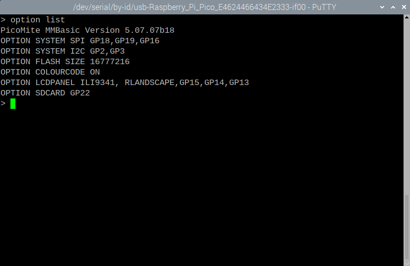

Hi All;
What is the lastest beta version of picomite and where do I find it?
I am running on a WaveShare RP2040-PLUS, fantastic board BTW.
I am running 5.07.07b18 and having issues getting I2C configured for my rtc board.
I am also running ILI9341 lcdpanel wired as specified in the manual. It and the on board sdcard work fine. I have not wired or configured the touch circuit yet.
Here is my OPTION LIST;
I thought it would have configured on gp2 and gp3 but I2C Detect.bas does not see it and errors out with an error message "Error : Pin not set for I2C".
What am I missing?
Suggestions please and thank you,
Hans ...
Posts: 3418
Posted: 07:28am 10 Mar 2023
GP2 & GP3 are I2C2
OPTION SYSTEM I2C2 GP2, GP3
might be worth a try otherwise use GP0 & GP1 or GP4 & GP5.
See diagram on page 5 for more.
Posted: 08:39am 10 Mar 2023
  Quote  I thought it would have configured on gp2 and gp3 but I2C Detect.bas does not see it and errors out with an error message "Error : Pin not set for I2C".
As Phil99 says GP2 and GP3 are I2C2 so you need to modify i2cdetect to use I2C2 and then it should see the rtc
Posts: 9253
Posted: 09:54am 10 Mar 2023
Doesn't OPTION SYSTEM I2C automatically figure out whether it's I2C or I2C2 from the pins used? The manual says nothing about a OPTION SYSTEM I2C2, but the 2 does need to be specified when using I2C(2) OPEN.
OPTION SYSTEM I2C sdapin, sclpin so GP2, GP3 should work. (Unless things have changed in this department since the 5/07.04 VGA manual).

Posted: 10:18am 10 Mar 2023
  Quote  Doesn't OPTION SYSTEM I2C automatically figure out whether it's I2C or I2C2 from the pins used? The manual says nothing about a OPTION SYSTEM I2C2, but the 2 does need to be specified when using I2C(2) OPEN.
Yes it does, but the OP is running a Basic program to detect I2C devices and that needs to select to correct I2C channel
