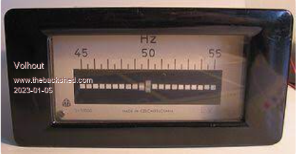

How they did that in 1950. Well, that is not to difficult. Early electronics did filter tones based on "tone relays". This is like a normal mechanical relay, with adjustable contact arm. The contact arm would be tuned for a certain frequency (resonance). You would only need a single coil, with many different arms, each with their own switch contact. The arm that resonates at that particular frequency would make a contact.
This is an article on a 1950's 6 channel RC system that used similar "tuned" reed relay contacts
And THIS you probably have seen before....

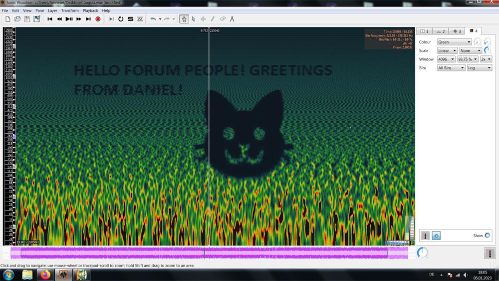

Maybe this helps or can be some kind of workaround or idea; there are a lot of programs which can translate images to a sound spectrogram, you can make it visible again with a nice program (free) named "Sonic Visualiser" (https://www.sonicvisualiser.org/) or any other program you'd like.
So with this program you can draw or convert any image to sound spectrogram:
https://www.abc.se/~re/Coagula/Coagula.html
YouTube Video Demonstration:
https://www.youtube.com/watch?v=6yn2NrewEZA
And with Sonic Visualiser (mentioned above) you can make it visible...
Some example I created:
And the wav:
Coagula.zip
Maybe some additional ideas for this whole audio spectrum idea! :)

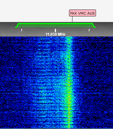

FFT displays have been used for many years as a tuning aid for FAX RTTY and slowscan TV and looking for signals over a wide frequency range.
Usually referred to as "waterfall display"
The picomite can do FFT so creating the image is easily doable.
Example of a waterfall display of a HF FAX signal received this morning.
(NOT using a picomite or any other 'mite)

Thanks for your response! I have never heard of Ton Relay before. Do you have a link to a schematic drawing? I have also not seen your frequency display like this before.

This sounds very interesting!!! Would be great if you could do that with a PicoMite!

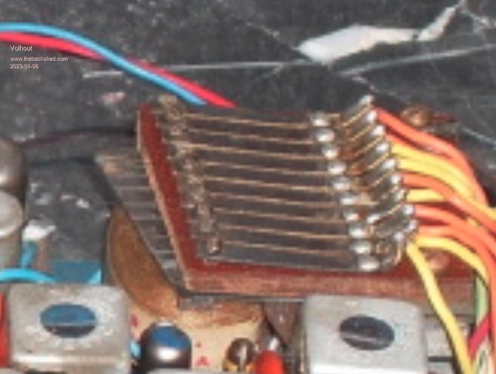

Hi Frank,
The colored wires are the outputs.
Under the brown phenolic you can see the 12 tone arms (different length, for different tones). And under the tone arms there is the single relay coil (yellow cylinder).
The tone arms are very similar to the ones in mechanical music box (rotating drum with pins)

Cool!!! Thank you very, very much!!!
