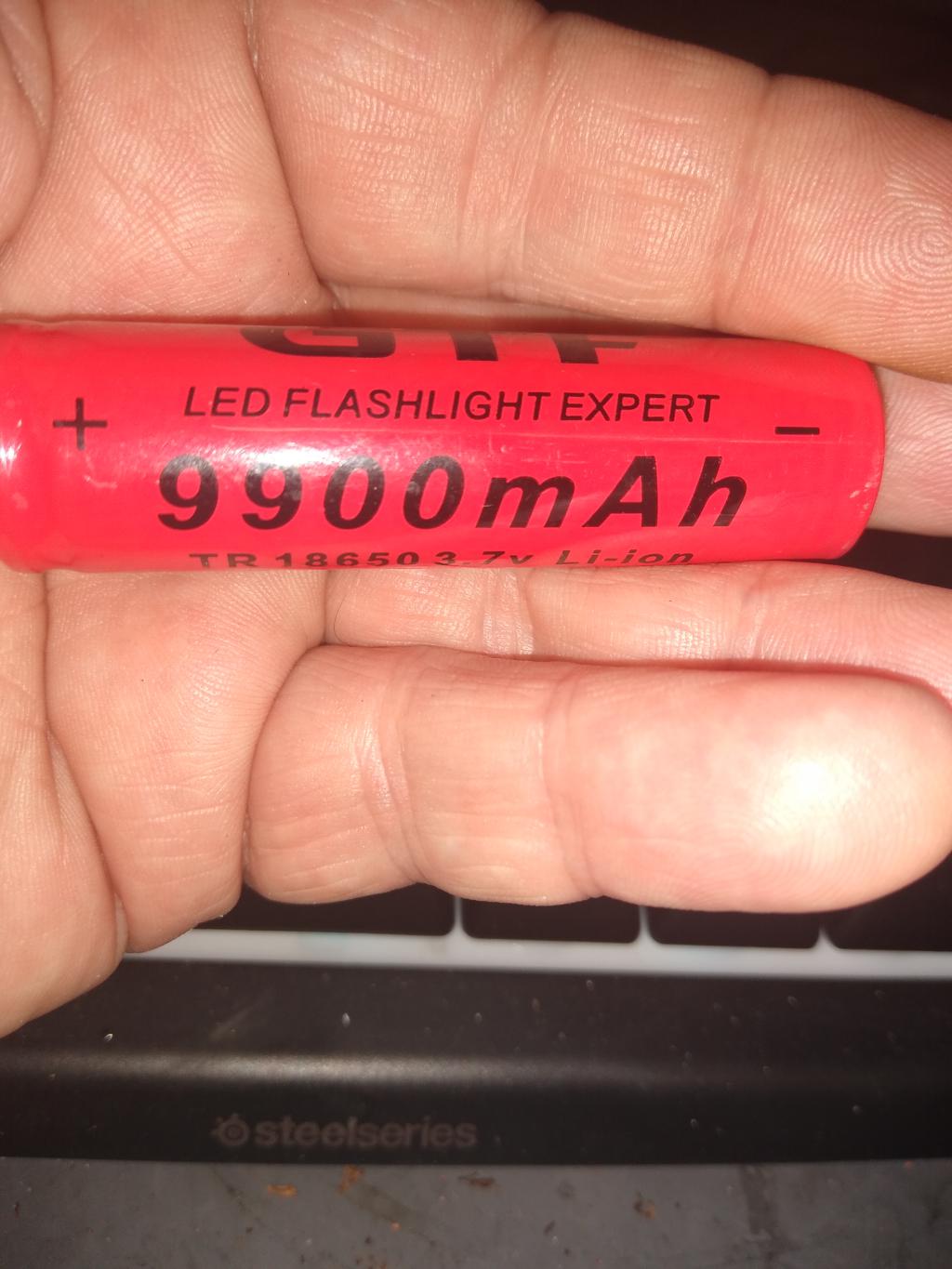

  Mixtel90 said  If you put 3 "Chinese 3300mAh" 18650s in parallel you get 10Ah (well, 9.9Ah ...
But that's 9.9Ahr at 3.7V, not at 12V--36Whr as opposed to 118Whr.
Posts: 9260
Posted: 12:28pm 03 Nov 2022
That doesn't stop advertisers. The battery says 9.9Ah, so that's what it's advertised as. It's very unlikely that a AliExpress Chinese company would differentiate the theoretical from reality. :)  In actual fact you're lucky if it works to spec, doubly lucky if it doesn't catch fire at some point.

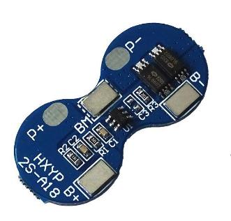

I still think that 6-cell 12V 18650 configuration has interesting possibilities.
The input charger is 12V.  It could, in theory, have an in-line 3P2S bms circuit board (I've seen a 2-cell version, and don't know why it couldn't scale up). With a nominal voltage of 3V7, the parallel output would only be 11V1, so would need a boost to 12V8 (or so), but that's a trivial module--a few dimes (but maybe beefed up some to provide 2A continuous).
2-cell 18650 BMS: here

  Mixtel90 said  That doesn't stop advertisers. The battery says 9.9Ah, so that's what it's advertised as. It's very unlikely that a AliExpress Chinese company would differentiate the theoretical from reality. :)  In actual fact you're lucky if it works to spec, doubly lucky if it doesn't catch fire at some point.
I can attest to the fact that this is total BS

10A... for an hour...
I'll eat what's left of my hair if that 18650 comes anywhere close.
