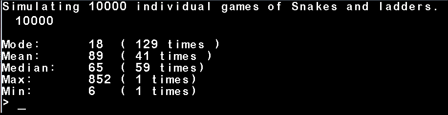

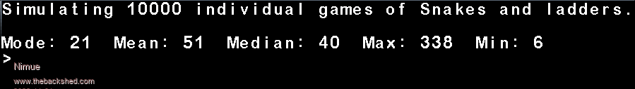

In the board designed below - interesting to see the range of rolls.
edit:  edited to return the index of the bin (ie roll value - and not just the count)

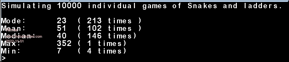

Final update - day job beckons.
