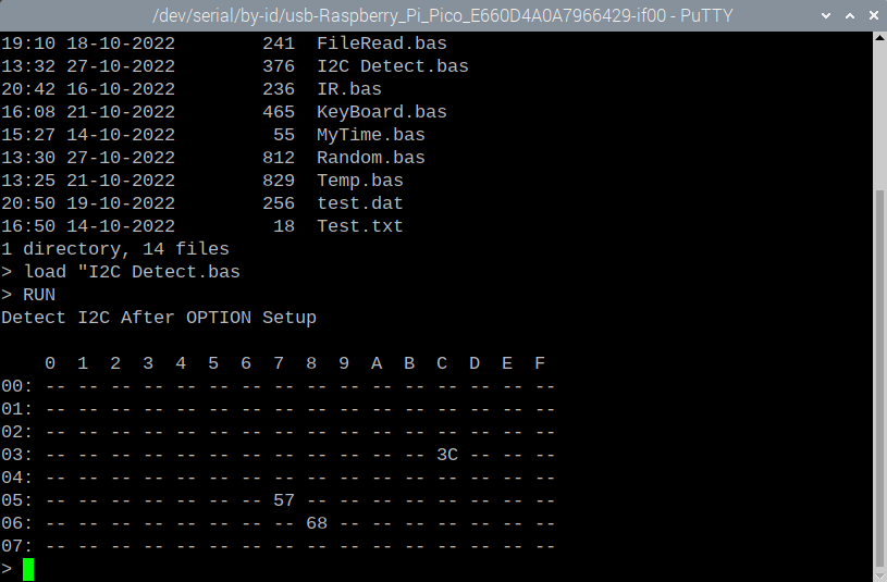

I try to find I2C address and got 0x3c, but I can't put it any were.

I have an RTC on the same I2C bus as the SSD1306 and I used option rtc auto enable to have the date and time read when the PICO starts. My assumption is that it knows the address because of that.
The clock is at H68, Memory at H57 and Display at H3C. The only thing I have to address in a program is the Flash Memory. The rest just works.

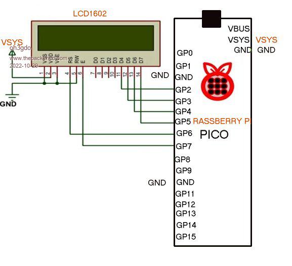

I took GP6 (En) and GP7 (RS) like in the picture.
I think this doesn't matter.

Posted: 12:52pm 29 Oct 2022
VEE should be connected to a potentiometer between VSS and VCC. The display may be working but you aren't seeing anything because the contrast is zero

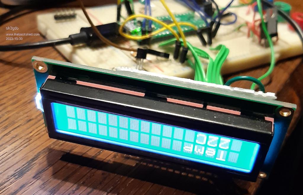

Now I found my problem with my LCD 1602.
I was started to put LCD pins from pin 5, although it was should start from pin 4.
In the pictures was missing gnd pins, although it should not happend.
Thank you who will help me.

matherp is right - if you put a potentiometer of around 1k-5k between GND and 5V with its slider connected to VEE then you can adjust the contrast. Those character positions that you can see can be faded out almost to the point where they can't be seen. start with the slider at mid way and "tune" it to taste.

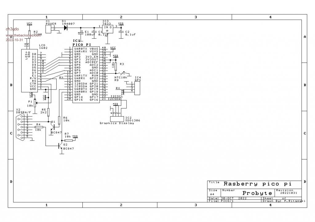

I did my first PCB today.
Here is schematic
I is nothing to work, but I am sure that when can handle PICO more, it will find some work.
Regards Pekka Ritamaki
