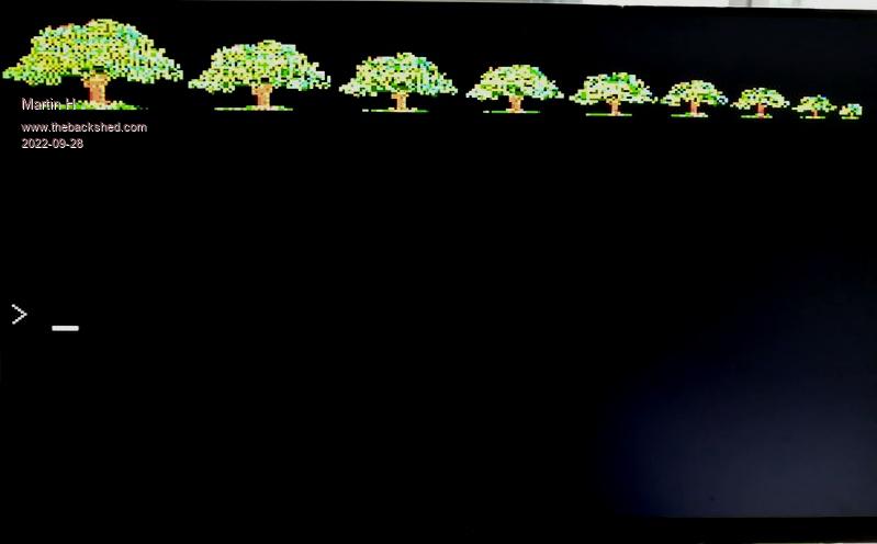

Posted: 09:01am 28 Sep 2022
example to Scale a Picture
for better readability I left the data uncompressed

'no comment
Posted: 12:00pm 28 Sep 2022
  Martin H. said  example to Scale a Picture
Very nice. Thank you.

Martin- brill demo. I would not have thought of scaling sprites. thanks for sharing.
Very nice indeed! Ausgezeichnet!
That scaling algorithm is remarkably effective. Thank you!
Martin H.
Joined: 04/06/2022
Posts: 1574
Posted: 01:20pm 29 Sep 2022
It was more for guiding. :-)
There is still room for improvement.
As the routine paints over some pixels that have already been set.
this can be prevented, by changing your view from source to destination.
If a row in destination is just 40 Pixel, then Query just the 40.
'no comment
