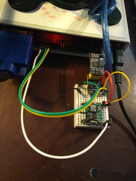

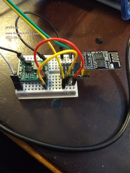

I wanted to connect the Colour Maximite 2 to the internet.
My setup is an ESP8266 chip connected to ports 4,6,8,10 of the CMM2. Pin 8 & 10 are for TX/RX of com1: and pin 4 & 6 for VCC and GND. In between I put a dc-dc converter which generates 3.3 volts for the esp from the 5 volts comming from the cmm2. the TX/RX are connected cross over ("null modem") TX Cmm2 to RX ESP and vice versa. The ESP chip enable pin is sourced from the 3.3V comming from the buckboost converter.
