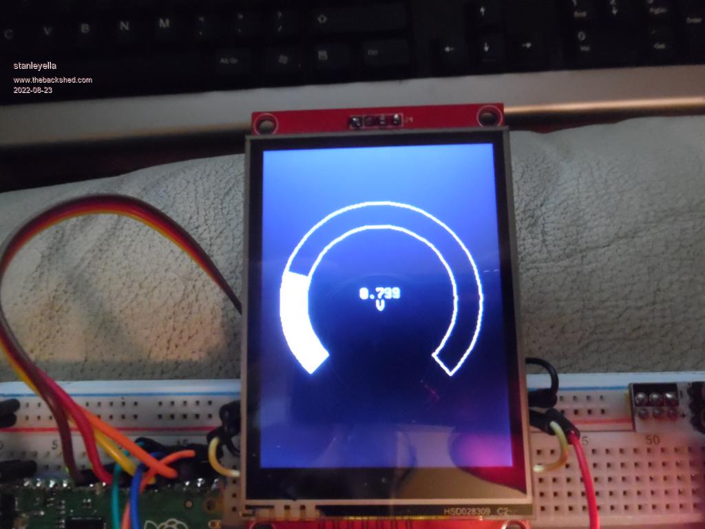

I am trying to set up gui gauge but get Error: Argument count.
I read using commas for un needed parameters was ok.
I did use OPTION GUI CONTROLS 75.
Please point out my error.

gui gauge #1, 120, 160, 100, wh, bk, 0, 3.3, , , , , , , , ,

Forget it. Seems more parameters and ok. groovy!

gui gauge #1, 120, 160, 100, wh, bk, 0, 3.3, 3,"V" ,wh

Posted: 07:49pm 22 Aug 2022
  lizby said  Try it without trailing commas.
Sorted it out. Seems you got to have the numbers displayed and number of places and a string which I just guessed could be "V".
I thought you could just have the dial bit. A few examoles in the manual would help imho. Too much is guessing.
