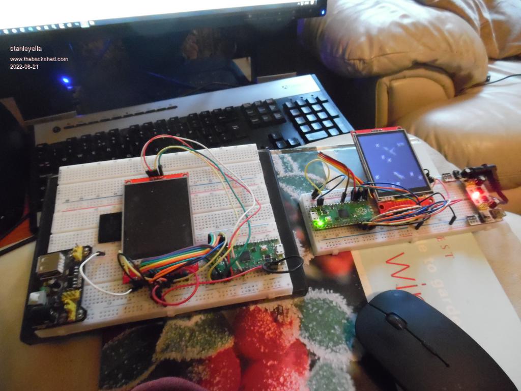

Thanks for the advice. I just setup rpipico third one and soldered headers so button is up and can not see the useless labels.
Loaded mmbasic, connected ili9341 and powered it from vbus which measured 5V but flashing horizontal lines partially across the lcd. Hmmm... Using 3.3Vout sorted it.
I used the example ili9341 setup in the manual and it all works, display circles, touch calibrate and touch test and read files on sd card all working.
Maybe soldering the headers other way could have damaged second pico but it worked in  teraterm.
anyway I'm pleased pico 3 is working as a spare.

I notice pico 1 is com13, pico 2 is com 14, pico 3 is com 15 and it is remembered on win 10. I had to reset mmedit for new com but easy and works.
The ili9341 in the manual works. The wiring and the options.
I am glad I set up the lcd for portrait.
now to start coding a-d. using manual and posted code examples.
