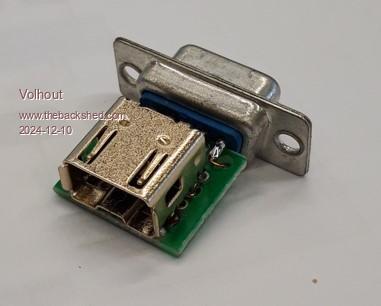

But these are nice. Made a small convertor using GP26/27 for I2C.
Adapter for PicoGameVGA port A.

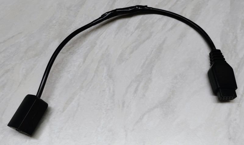

Much neater than mine. I spliced two controller extension cables together, made a mess of the heat shrink and ended up bodging with insulation tape. IIRC it's not a thing of beauty inside either .

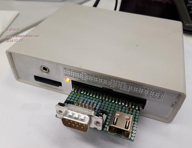

Maybe you want to use the on board switcher, using the DAC the noise is not an issue (the DAC uses it's internal reference). The linear regulator is needed for better performance on ADC and lower audio noise (and maybe VGA video noise, but I have never seen that on the LCD monitor I use, but HDMI is digital anyway).
But you can set the switcher forced to PWM, battery efficiency is not so much of an issue when driving a HDMI bus powered from mains.
Finally got rid of the "aligator clips" nunchuck/classic connection. PicoGameVGA port A, and nunchuck connected to system I2C bus.
