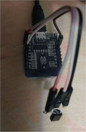

So what can you do with this little ESP8266 D1 Mini?
Here's a DS18B20 connected to the D1 Mini with flying Dupont wires:

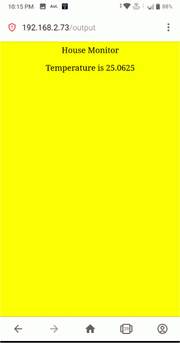

How about serving a web page so your phone can read the temperature?

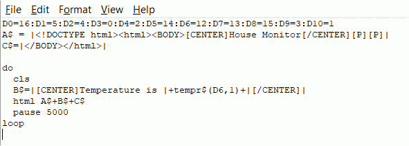

Here's the code (bugger--the forum is interpreting the HTML--so a pic:)
Here's a screen shot:

Now on your phone it looks like this:

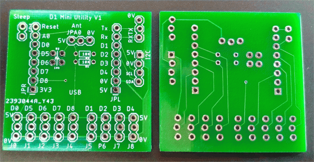

You want a PCB?
Here are the gerbers--$6.40USD for 5 at JLCPCB, with slow boat delivery.
D1Mini_shield1v2a_2022-04-05.zip
