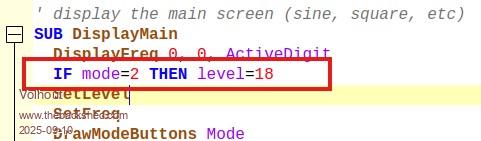

I have modified as you suggested and it definately makes the Square wave better, presumably it was being over driven before. I changed my level to 18, because it gave me a 3V p/p square wave, which is the same as the Sine wave at 100%.
 If Mode<>LMode Then
  LMode=Mode
  If Mode=2 Then
   LLevel=Level
   Level=18
  Else
   Level=LLevel

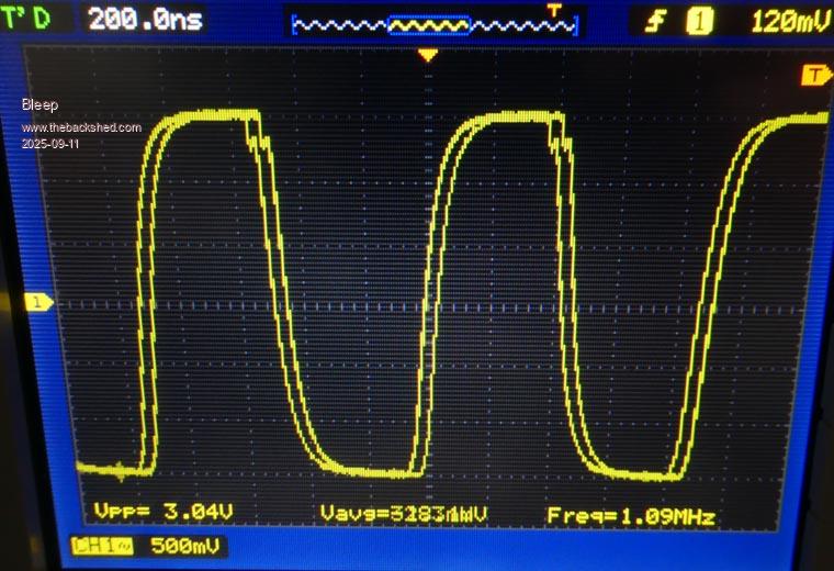

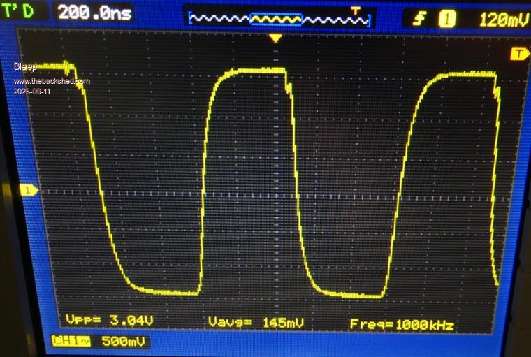

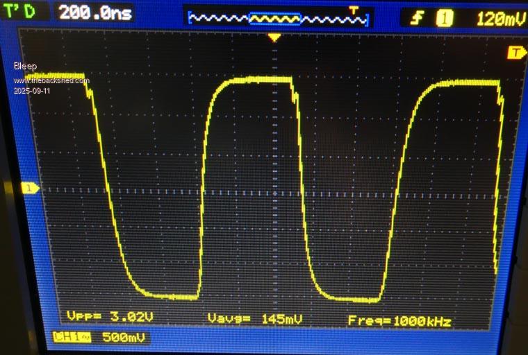

I do find there is a strange 'jitter' on the square wave, for want of a better word, I assume it is to do with the crystal divider, though I still get a very slow change, about every second even if I select 1MHz, which I would think should be a perfect devisor frequency. If you look at the following 2 images, taken about 1 second apart, you can see that the falling edge moves, the rising edge is steady.
This image is when I select 1.1MHz, which would be a devisor problem.
Otherwise the Square is definately an improvement, Thanks. :-)

The "jitter" is exactly what I saw (the numerical divider alternating between 24 and 25 (or 25 and 26). However, this seems absent in the sine and triangle (the DDS signals) waveform.
I copied your solution on the software. Maybe Geoff can apply that minor code change also to the code on his web page.
