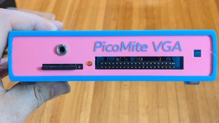

That looks so cool, scruss... and no clash with the purple PCB at all. LOL!
